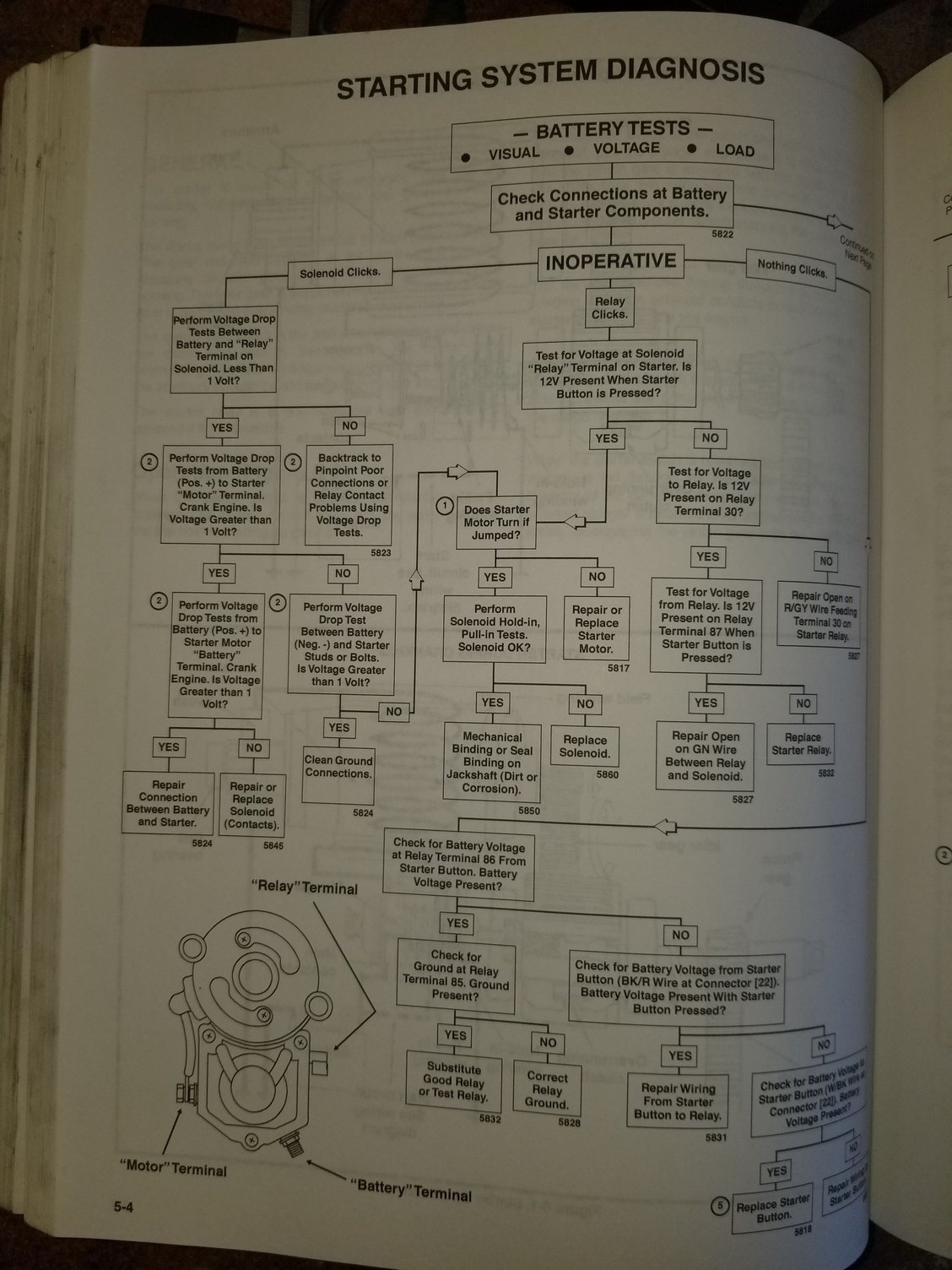

Just re-read your previous comment. So the tail light and headlight dimmed and brightened in time with your flashers ***with the engine running ***.
This is meaningful because if it only happened with the engine off it wouldn't be too surprising. That it happens with the engine on? I don't envy the diagnostics it might take to sort that out.
Anyway, the two issues may not be related.
I dont think the ECM is involved with your lighting circuitry so replacing that won't do anything for you.
I have a 2000 Ultra and here's the FSM diagnostic flow chart for the starting system. If you have the manual look up your diagnostics chart of follow it. My chart might even get you there.
