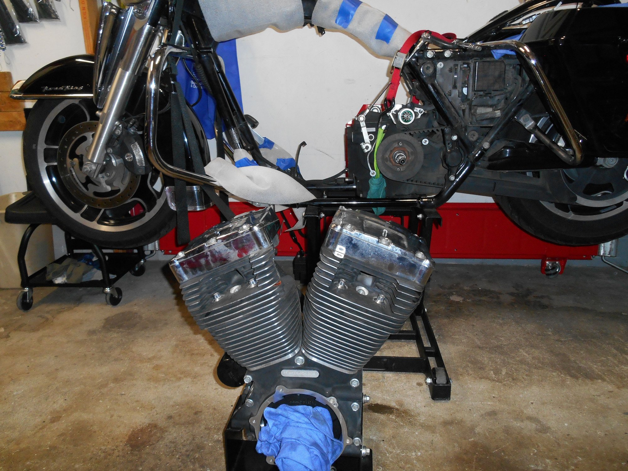

When people ask why I ride Harley Davidson motorcycles my answer is simple and it usually flies right over the questioner's head. Because I can. Because I can make an overweight pig go around a corner and leave some on better machines like they were tied to a post. Because when HD's **** poor design threatens to keep me from riding I yank it out and make it better in my own garage. Please take this in the vein it's offered, the typed word doesn't always convey that. You have but two choices; fix it and go on or cut and run, either way HD is gonna go on without you so all you're doing is cheating yourself. Below are two pictures. One is of my newer Road King that wouldn't pull a sick ***** off the pot; I rectified that The other is of a real problem. While I was in treatment for cancer (that I had no life choices that led me to it) some of my friends came over, poured my skinny *** on one of my motorcycles and had me lead them on a 20 minute ride that left me knackerd. When you're below the 140 pound mark and things look pretty bleak, small stuff doesn't even exist (I'm the one in the black leather jacket and pants). I hope you don't' ever have a revelation such as mine but how you approach small problems in life is exactly how you're going to handle the big ones. Ride that HD in spite of them.
