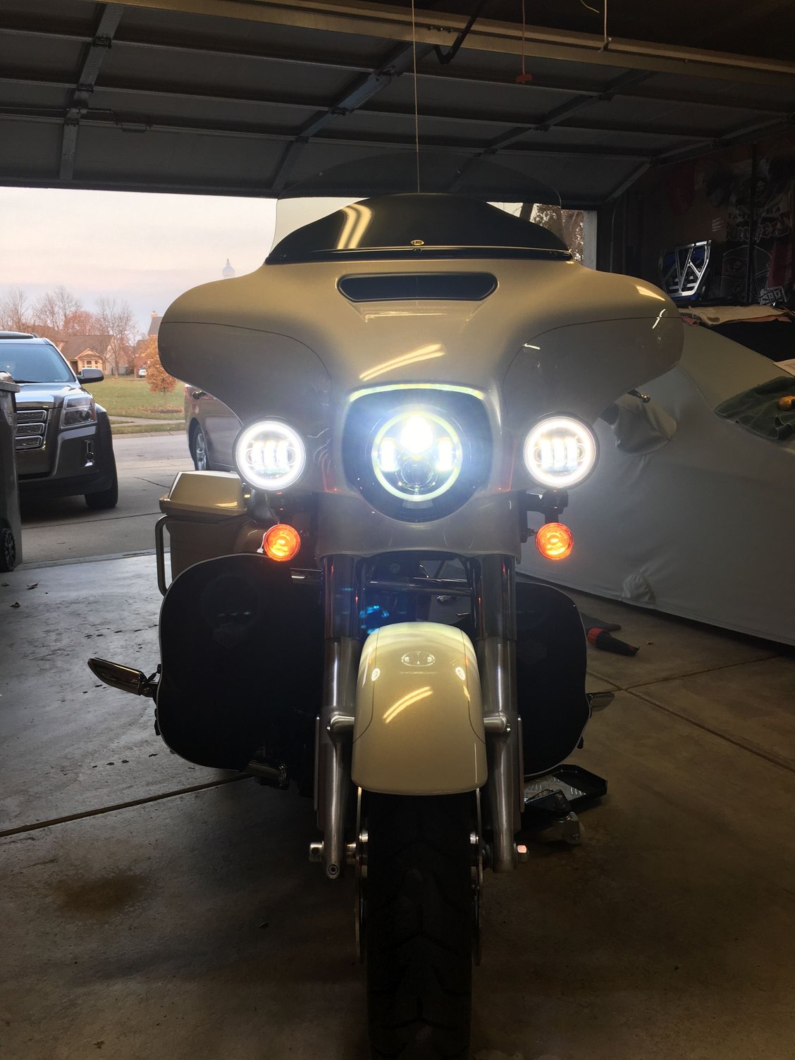

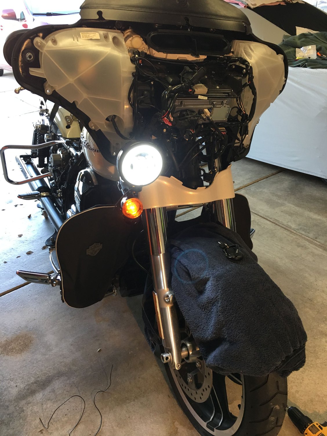

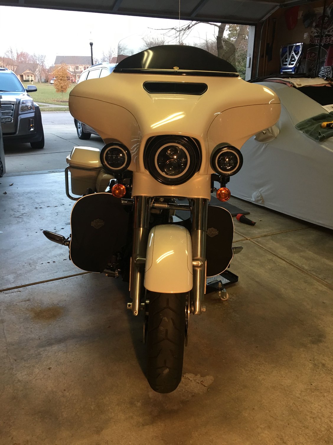

OK, so I installed the Aux lights today in @ 2 hours... Fortunately... it was simple and pretty easy
1. Ordered the parts above
2. Really I only needed the Switch and Aux Light Kit & Aux Lights, the hanress is extra but I wired it in anyway for Aux 2 and Aux 3 fuctions in the future.
3. Pulled the fairing and dash
4. Wired the Hogworkz Aux LED Halo lights per their instructions
5. Installed the 3 button switch and connected to the OEM harness plug that already is present to the Dash, and was plugged into the dummy switch blank
6. No Flash invloved
7. Aux lights dim when Bright lights are on, I''m good with that
