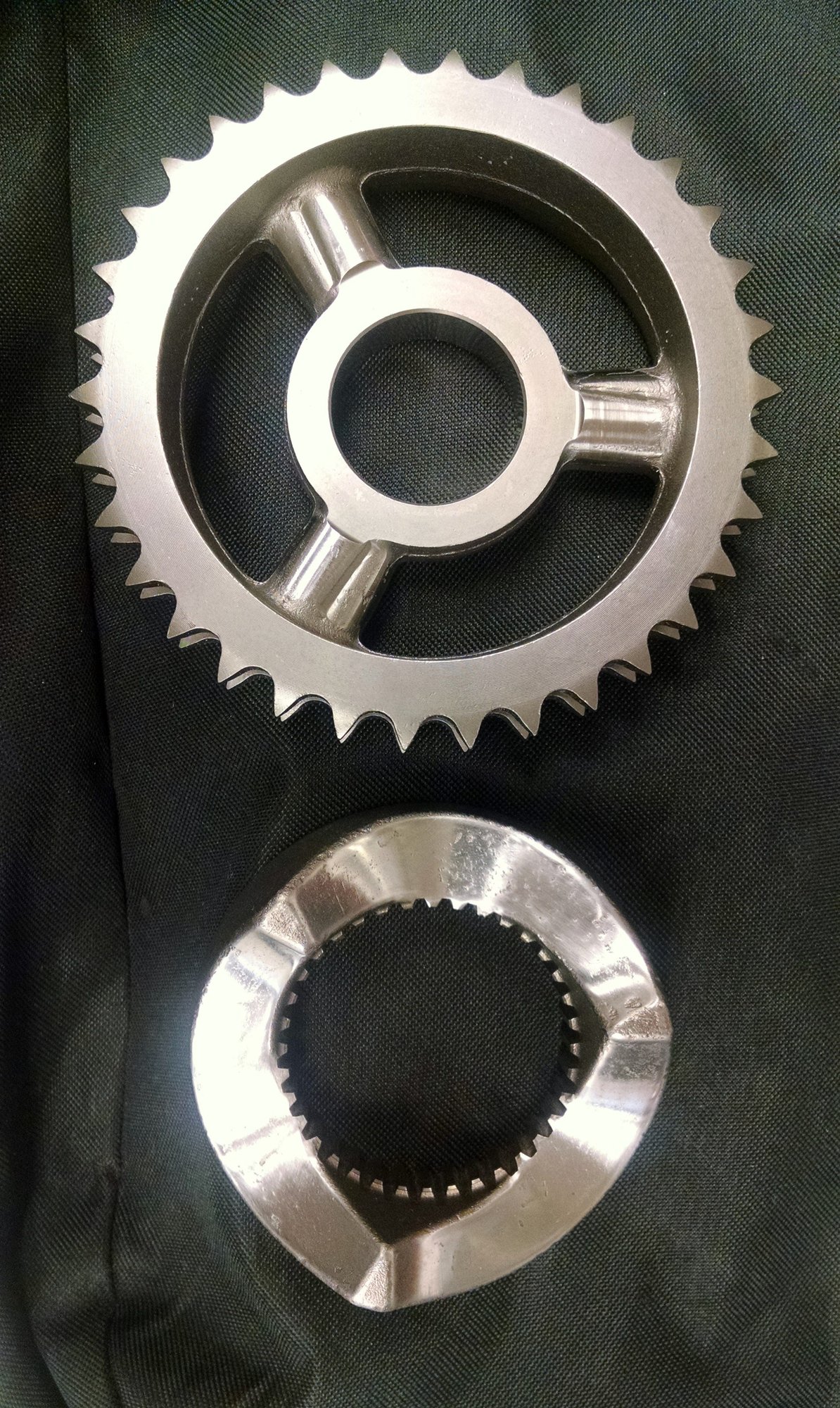

Default compensator
Myself and a few local friends have found a cure for most of the compensator problems that we have experienced ( Ultra's and Road Kings). On the newest version that spins the oil ( 42200064A) we have been polishing the contact surfaces , ramps and spokes to stop the wear and self-destructiveness . Myself and others have over 50,000 miles on them , no more metal particles in the oil and at 45,000 miles there was zero visible wear , no slop in the springs and no rattle or noise while running. Most of us also pull trailers and have stage 3, can't say it solved the problem altogether or forever but we are more than happy with our results .
