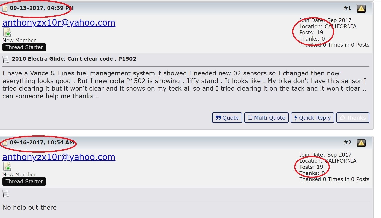

? lol....what one post and question per year?
https://www.hdforums.com/forum/touri...l#post16633963

What even stranger is your post count is not changing. Even your first post above is at 19. ??? may want to ask a moderator about that. Good luck w/ your issue/ I searched the forum for solutions, that's how I came up w/ your original post.

yep, I searched the forum for him, hence finding his original post.
