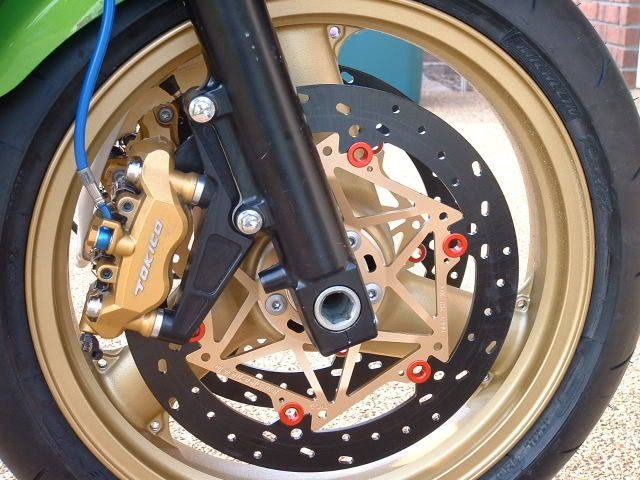

Anyone running the radial brake calipers on their bike, did they improve braking? I'm thinking of buying the brackets and running a set of R1 1 piece calipers or making brackets for a set of tokico 6 pots I have in my parts bin.

Is this something you just want to do, or has poor braking performance caused this? There is information about cleaning the pistons on the factory calipers to restore proper braking in the maintenance section. That action periodically on all manufacturer's calipers helps maintain designed in performance. On every brake pad replacement I have done, at least one piston is bound, so just brake dust will cause this problem. Cleaning and freeing the pistons restores like new operation.

Not radial but had ness 6 pots and 13” rotors on my old ‘99 RG. Pretty impressive! But, The stock Brembo calipers work pretty good and putting larger rotors (and caliper mounts) on them is a good (and cheaper) improvement.

The power is in the pistons, not the mounting bolts.
Why not just go for a set of standard mount tokico 6 pots? Lot less work and expense if you are not going down the upside down fork route.
I see someones have or do make adapters for radial to fork slider conversions. It may also allow for fitting larger disks too. No idea if anyone does them for HDs. I suppose it would depend on which parts you can get cheapest, although you would not be the first HD rider to spend more just for cool or the bragging rights!
These are on a Triumph ... but only 4 pot.
If I were you, I'd be looking at which have the best longevity, are the most easily serviced, and the cheapest to run, eg some six pot calipers have six small pads which are a pain, others flex, ones designed for racing lack 'feel' for the road and require more prepping etc.
There's more to brakes than just locking up your front wheel.
But, hey, probably would not take much work and expense to graft on an entire, upside down front end complete with wheel and brakes ... but then you'd still have to work out spring and dampening ratios.
Do any of the big Japanese cruisers have them? That's be the easiest swop. The front end of a Harley is all foreign, and mostly Japanese already (made by Showa who also do Nissin)*.

I would go a full usd front end, just don't have the time to get into that right now. I used to turn all my sport bikes into streetfighters, so there is a drive to do something different for looks but also the brakes on this bike are mushy and don't have a lot of feedback for trail braking. I have a set of tokico 6 pots from my oil cooled days but the new radial one piece will out preform them, I can get the 108mm radial conversion mounts for $100 which makes it fairly cheap swap. I guess I'll just have to give them a try, worst case is it brakes a little better and it looses a few oz's, LOL.
