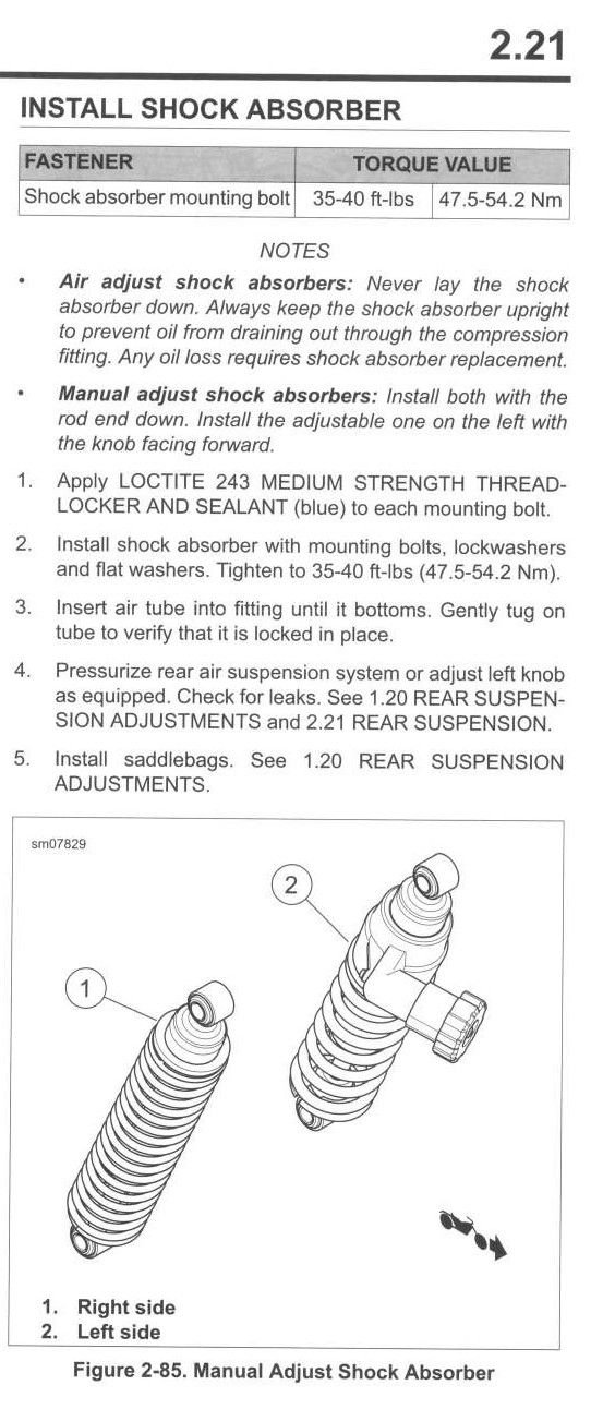

2016 FSM ... NOTE: Hand adjustable (and Torque Spec)

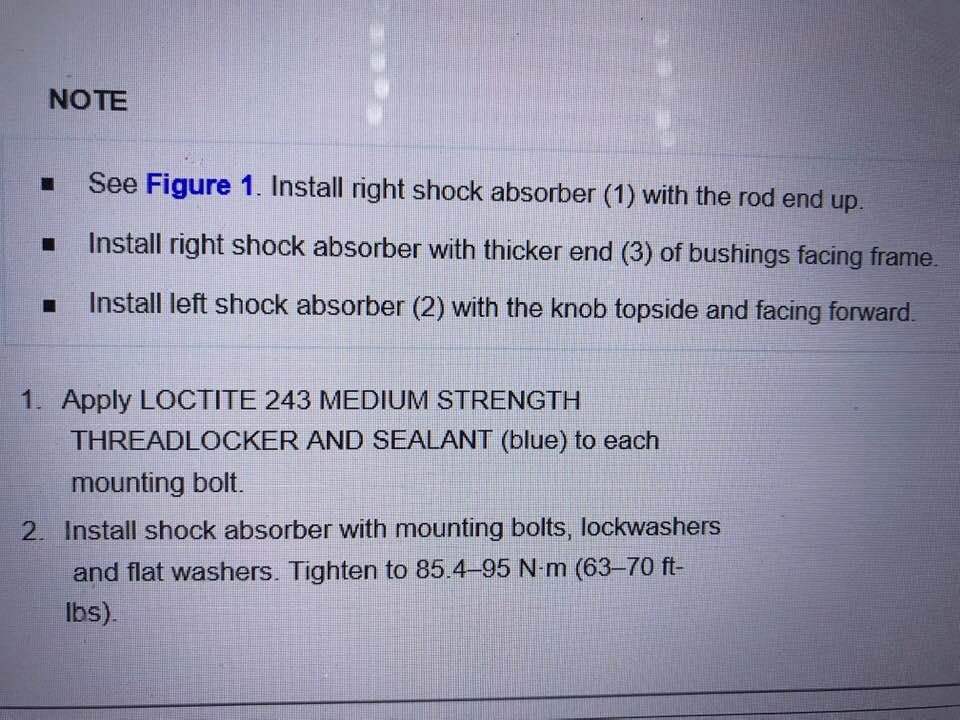

I stand corrected. I noticed the lock washer was eliminated on 17, and later. Perhaps the torque increase was due to that.

Manual shows 63-70 ft lb for my 18. Need to go recheck mine now since I followed the instructions that came with my Ohlins

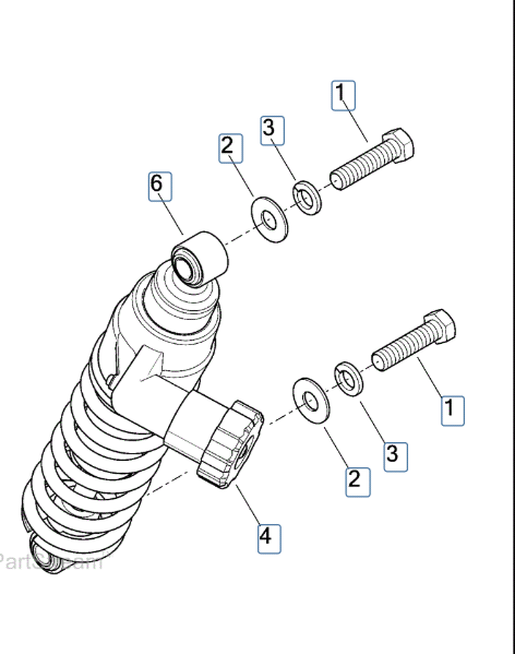

2016 shock hardware, # 3 is a lockwasher.
2017, and up shock hardware, flat washer (#2) only.
In my opinion, this would explain the torque increase stated in the 17, and later FSM.
