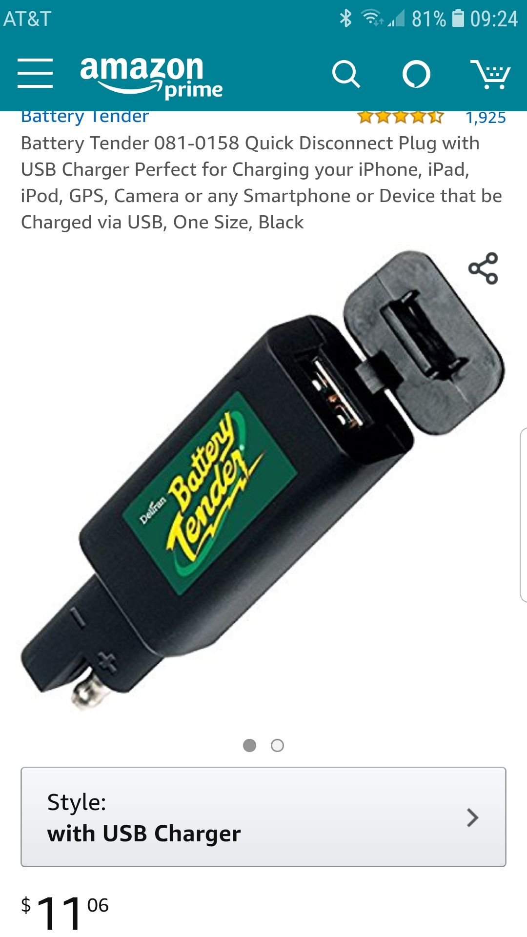

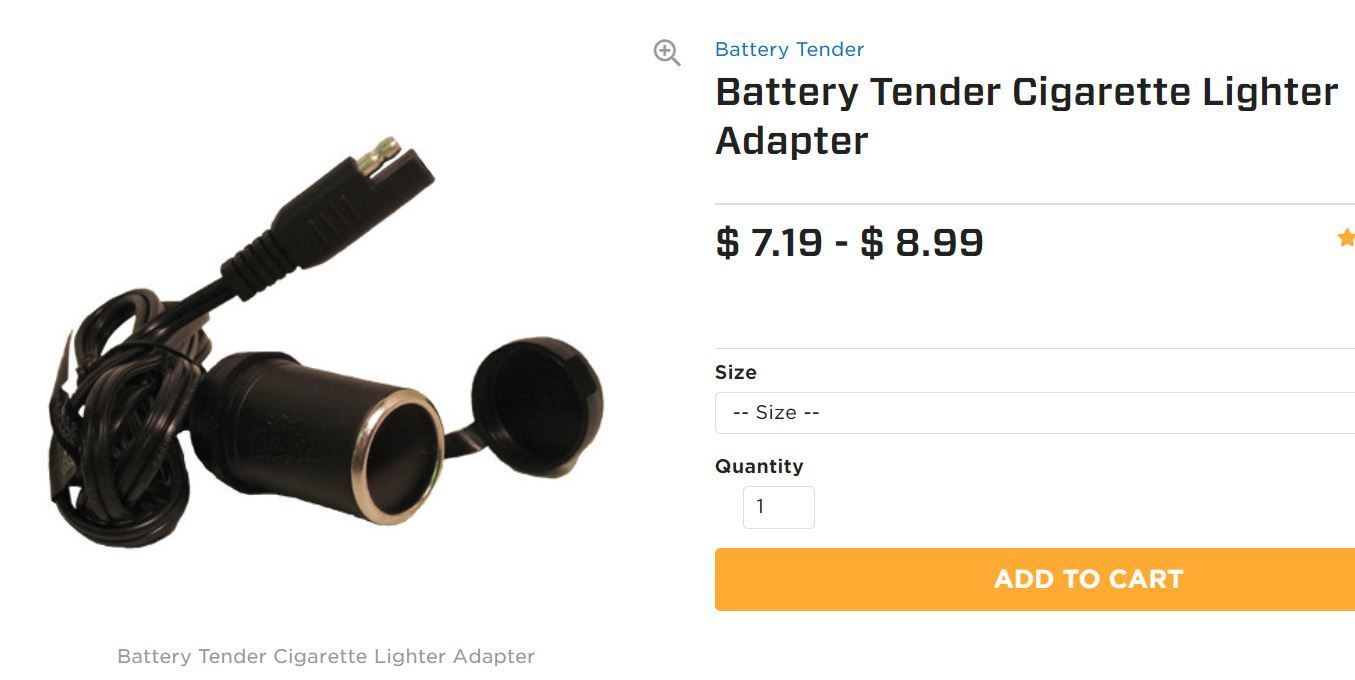

Wouldn't this be easier than all that wiring and drilling?
Also, I've got a small air compressor with the same pigtail in case it's ever needed. Just be sure the fuse in the charger pigtail will accommodate the compressor draw.

Yep, my compressor will plug into the tender pigtail, which I replaced the standard 7.5 amp fuse with a 15 amp fuse, and I also have that same deltran usb plug (That is a 2 amp) that I use for my passenger to charge Her smart phone.
My Slime Digital Compressor says it pulls 7 amps, and that was just too close to the 7.5 amp rating. I see no reason that the pigtail cable can't handle the 15 amp rating. Besides - just take a look at that pigtail to the battery - you cannot easily get to that fuse without pulling the seat!

Drill a hole? wtf? Hell no.
Most of us use battery tenders, this is a far simpler option and cheaper. I used to run one of these off the SAE pigtail on my battery to the saddlebag (old Softail), then could plug in and charge a phone while riding.
I am not seeing the benefit of this HD product.

One difference is the HD product will be powered off when the motorcycle is switched off. Depending upon how one has wired up their battery tender cable, that might not be true with the product you posted.
BTW: I have the battery tender product you posted a picture of.

My air compressor has a cig lighter plug so the HD power port works for my application. Personally I wanted a switched power outlet and as LQQK_OUT explained, the HD power port's power will be controlled via the ACC switch on the left side behind the nacelle of my RK, as opposed to always being hot if using a "Battery Tender Cig Lighter Adapter" plugged into the SAE pigtail of the battery as you suggest.
