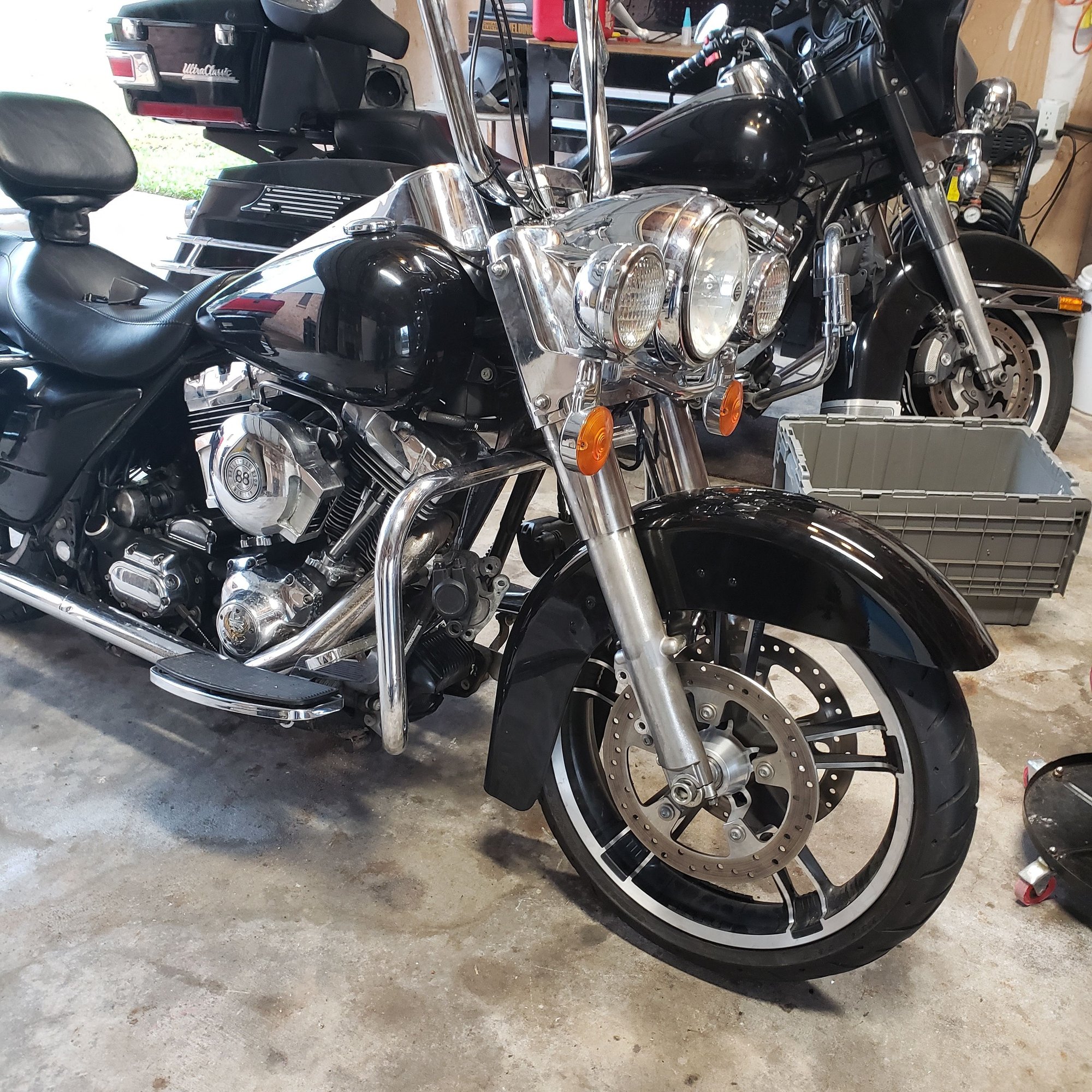

Old Feb 23, 2019 | 07:33 PM
Jeff Dodson's Avatar
Jeff Dodson
Joined: Dec 2007
Posts: 140
Likes: 6
From: Lake Jackson TX.
My 99 King
