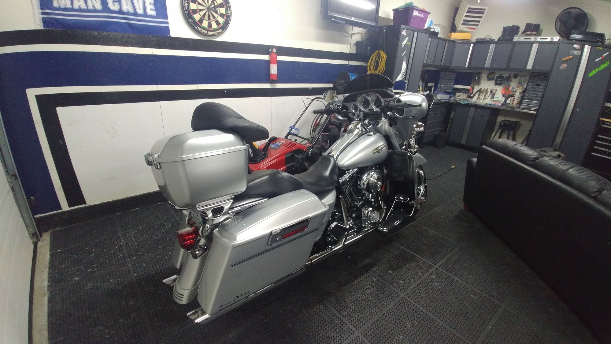

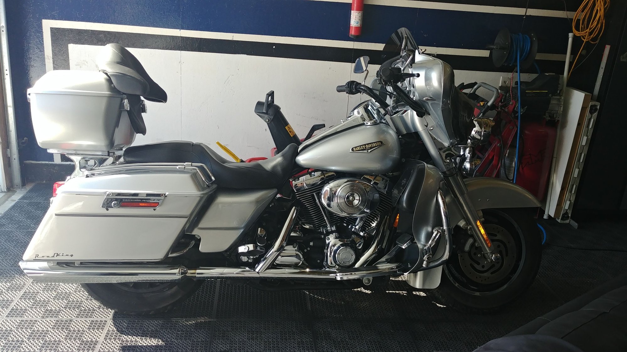

Hello from Winnipeg
First post here and hope many more
Picked up a 2004 Roadking Custom
Wanting to install 10" mini apes
Cables all reach?
Something about having to change brake master cylinder?
Any info would help
