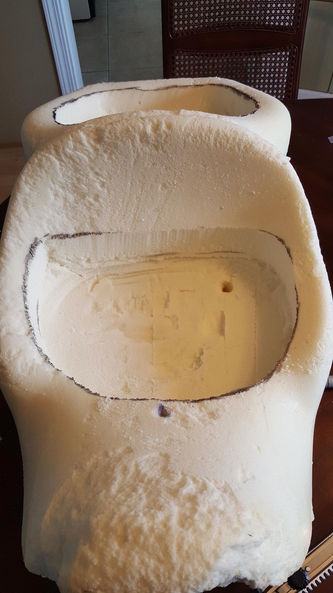

I just did my own seat. I have the pillow look HD seat. Decided to put some memory foam in. I looked all over the place for 10 Lb. memory foam and could not find any. I ended up ordering 3" 5.5 Lb. memory foam and used that. Have not riden it yet but just sitting on it feels good. Will find out in May when I usually put insurance on it.
Last summer we went on a week long ride and by the end our butts were getting a little sore. Seat is old, so figured it just was needing a little rebuilding. Hope it works out or I will be hearing about it from the wife in no time.

Eggman1
It is quite easy to do. Took me about 2-3 hours if that. What I did was I marked out where I wanted to cut and then used a Utility knife that has the type of blade that you extend and break pieces off when they get dull.
So I extended the blade out 2 ź inches and went around the out side of my pattern going straight up and down with a sawing motion so the cut would only be 2 ź deep. I then made cuts straight across the pattern and up and down the pattern about 1” apart so now you have a checkerboard affect in your cuts. You can now just carefully tear the squares out one at a time, once you get a few out you can have some room to use your knife and cut the bottoms of the others out.
I then used a disc sander with really coarse grinding pad on it just to even the bottom out. Now memory foam compacts alot, so I used 3” foam so that is why I only went about 2 ź deep. Used some paper over the hole so I traced exactly how big the cut was and used that as a temp plate to cut the new foam. Drawing out the pattern on the new foam I also added ˝ inch all the way around so your new foam will be lager then your cut hole. I cut that using a electric kitchen knife, cuts like butter no problem. I then used a good spray on foam glue and put it in.
Now you can put the original topping foam back on or buy some new stuff. I bought the black stuff just because that is waterproof. I then recovered that with plastic again and then replaced my seat cover.
Bruce
