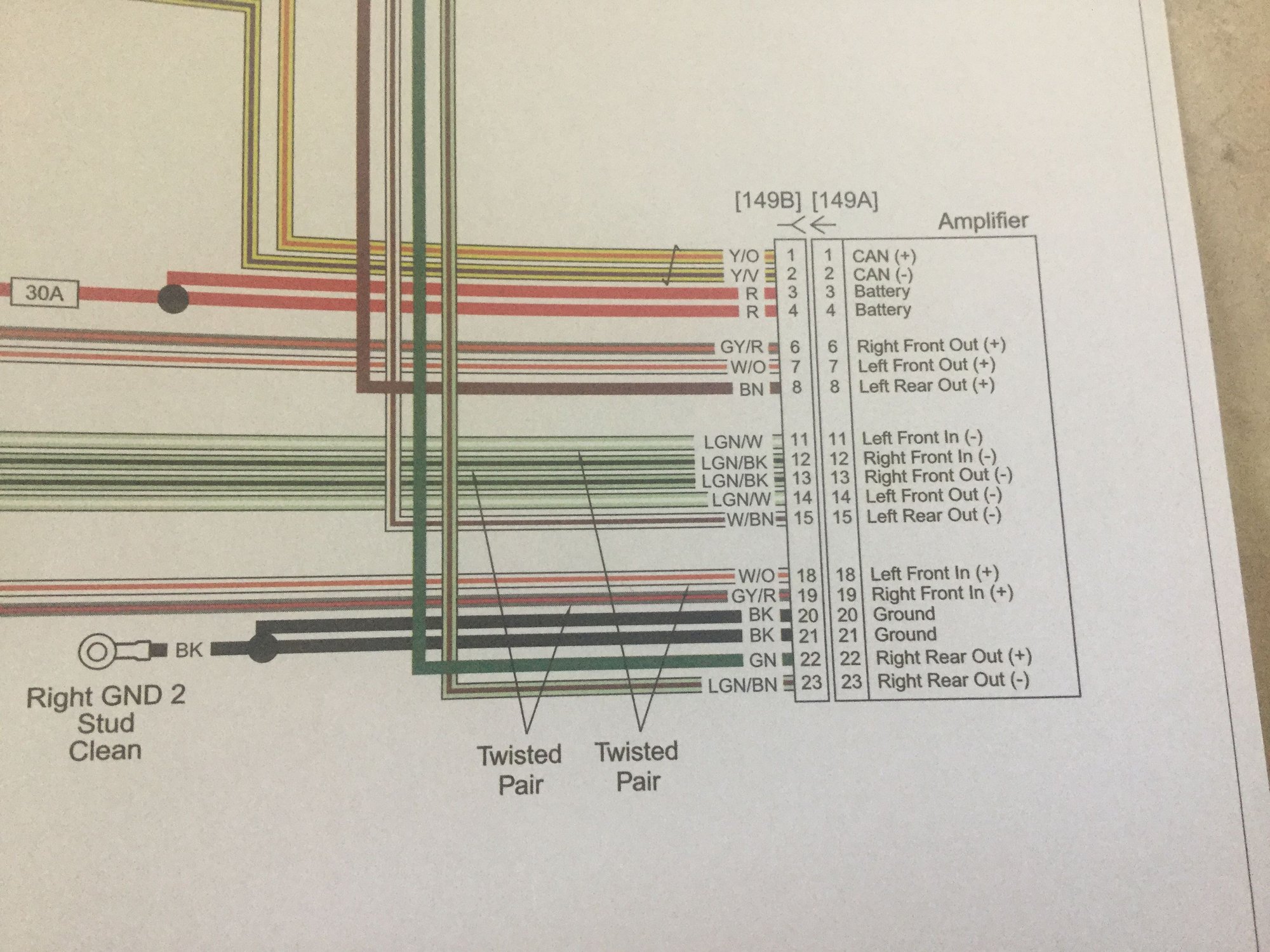

I have a brother of mine who just upgraded his sound system on his 2016 CVO Limited. He now has all the take-off parts from his Stage One Boom Audio. I have a 2013 StreetGlide that I’m looking to install these parts on (Speakers and Amp). Does anyone know if the 2016 parts can be hooked up to a 2013 bike?

I don't think you can use the Amp. I looked at my 2015 schematics and the Amp has a CAN - High and Low wiring for the CAN Bus communications.
The speakers are just + - so they should work.

Thanks! He’s bringing them down today, so I’m unsure of what the wiring looks like. I was hoping to jerryrig the system to “make” it work. 😂😂

This is from 2012 Ultra
