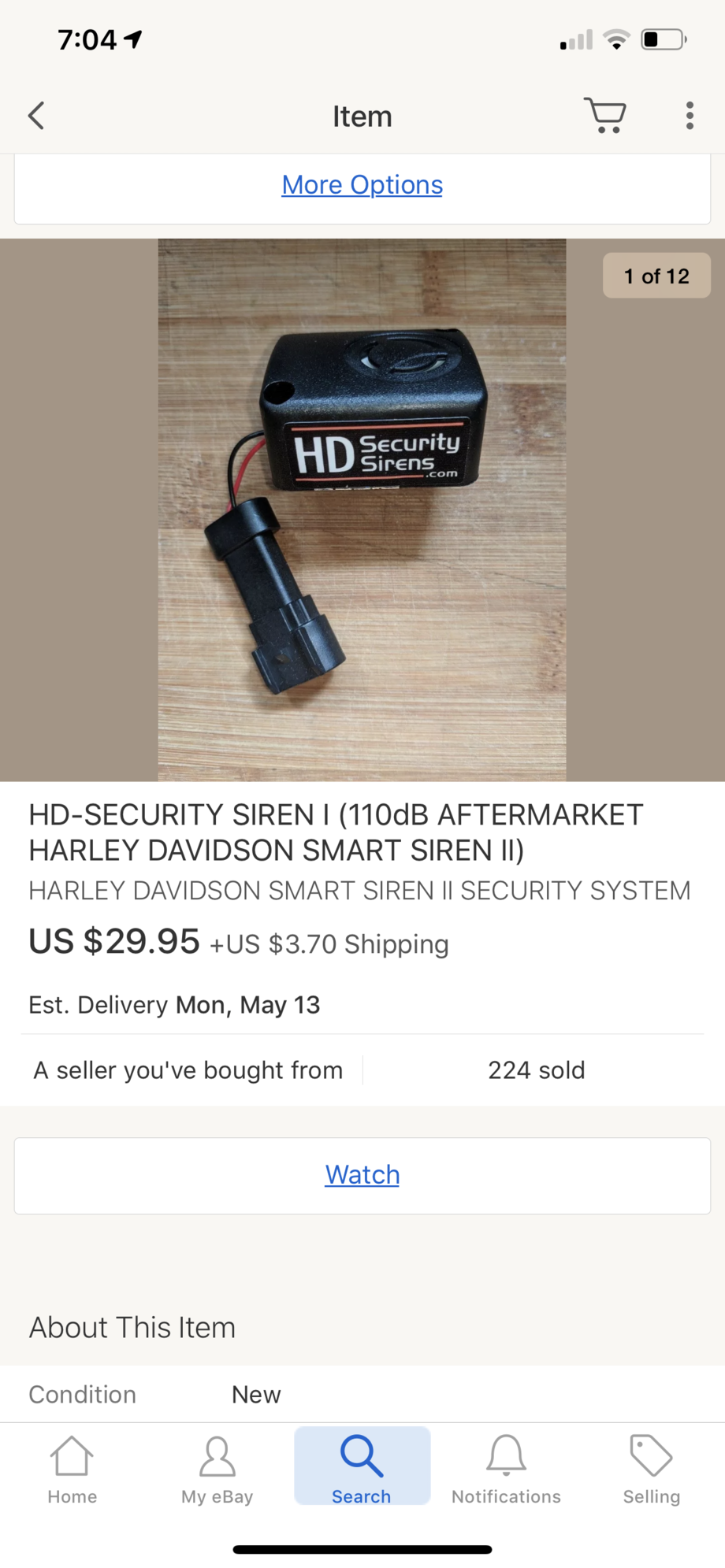

My friend has a 2012 Tri-Glide and recently added the eBay HD Sirens siren.
Since he he plugged it in (as instructed) his bike will start, but immediately shut off and his speedo shows “EIP”
he he tried removing it, cycling the ignition and pulling the main fuse, but it still shuts off.
From what hat I can decipher, EIP is a bank sensor code that shunts the fuel or spark so the bike shuts down if it tips over.
Im guessing the trike have the same electronics and it probably has one.
Any my suggestions on what to check?
it was running fine prior to installing the siren.
BTW, I have one on my bike, and it works fine.
