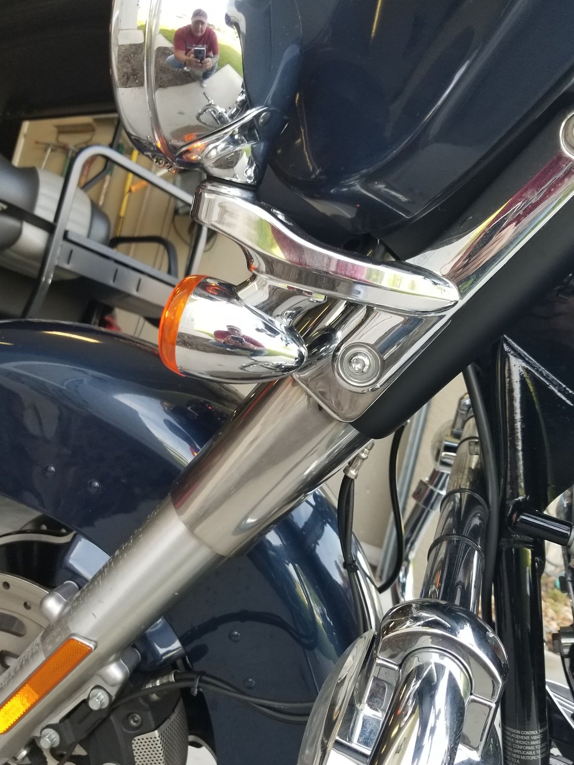

Old May 11, 2019 | 07:53 AM
rysonn's Avatar
rysonn
Joined: Oct 2011
Posts: 513
Likes: 17
From: Parrish, Fl
This is what's on it now...

These look to be kuryaken maybe so I would want to pull these off and replace with stock turn signals. I have ridden the 07 without the passing lights and have no problems. So i am guessing i just need to find a set of stock signals. It is the wiring that I guess i would have to figure out.
