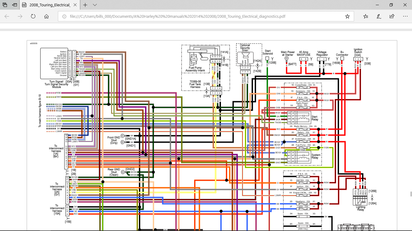

The battery fuse appears to power the TSM , Speedo and Tach. I would remove the fuse and check between the connectors and ground with an Ohm Meter while wiggling the wires. From what I see in the drawings the Battery Fuse doe not have anything to do with the head light. Since the short cleared when you removed the Fairing I'd look at the wiring there, between the interconnect harness and Tach And Spedo then Interconnect back to the fuse block.
