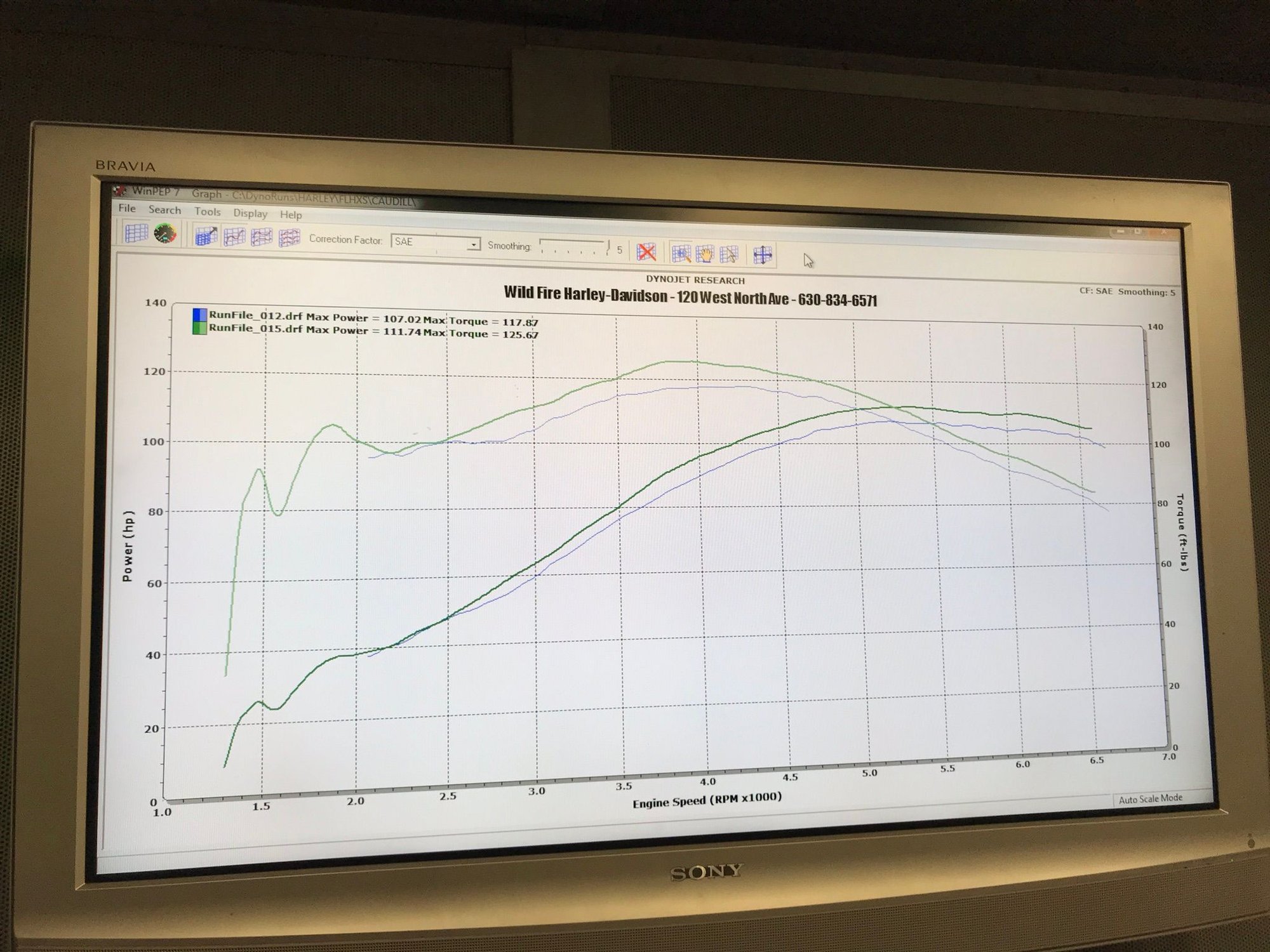

Wobble started about 500 miles ago. I have ridden approximately 4000 with all of the engine work done and never had and movement at all. Front tire has 300 miles on it because thought that might be it and was balanced but didn’t solve it. Bike has around 13,000 miles on it and every maintenance has always been done. Probably way more because a year ago I ripped about 7 teeth out of 4th gear in the transmission “which I will say Harley replaced” citing soft metal batch as the cause.
