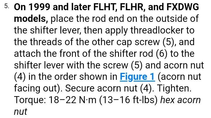

Here's mine on my 18 FLHXS. It's a straight line from front (inside) to back (outside).
And yes, the instructions appear to be incorrect.

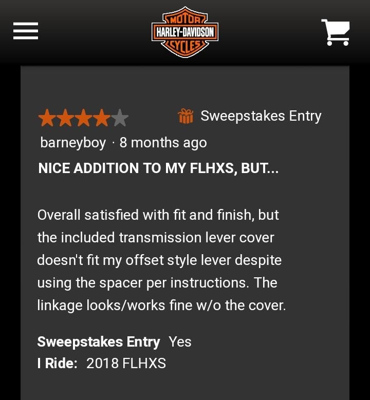

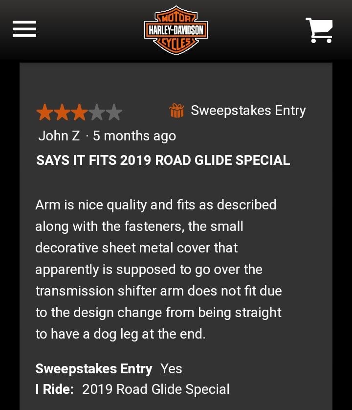

Mine wouldn't work either. I left a review on HD's website stating so. Another reviewer had the same issue.
