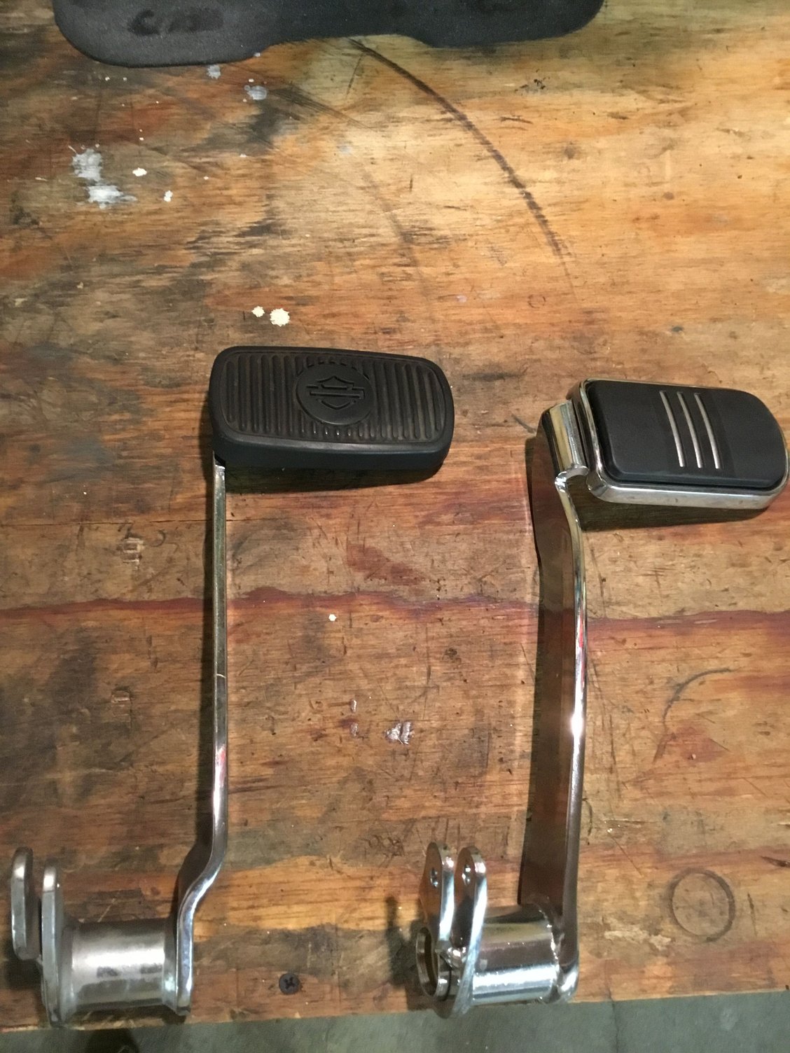

yup, it's fixed. Have to buy their longer pedal.

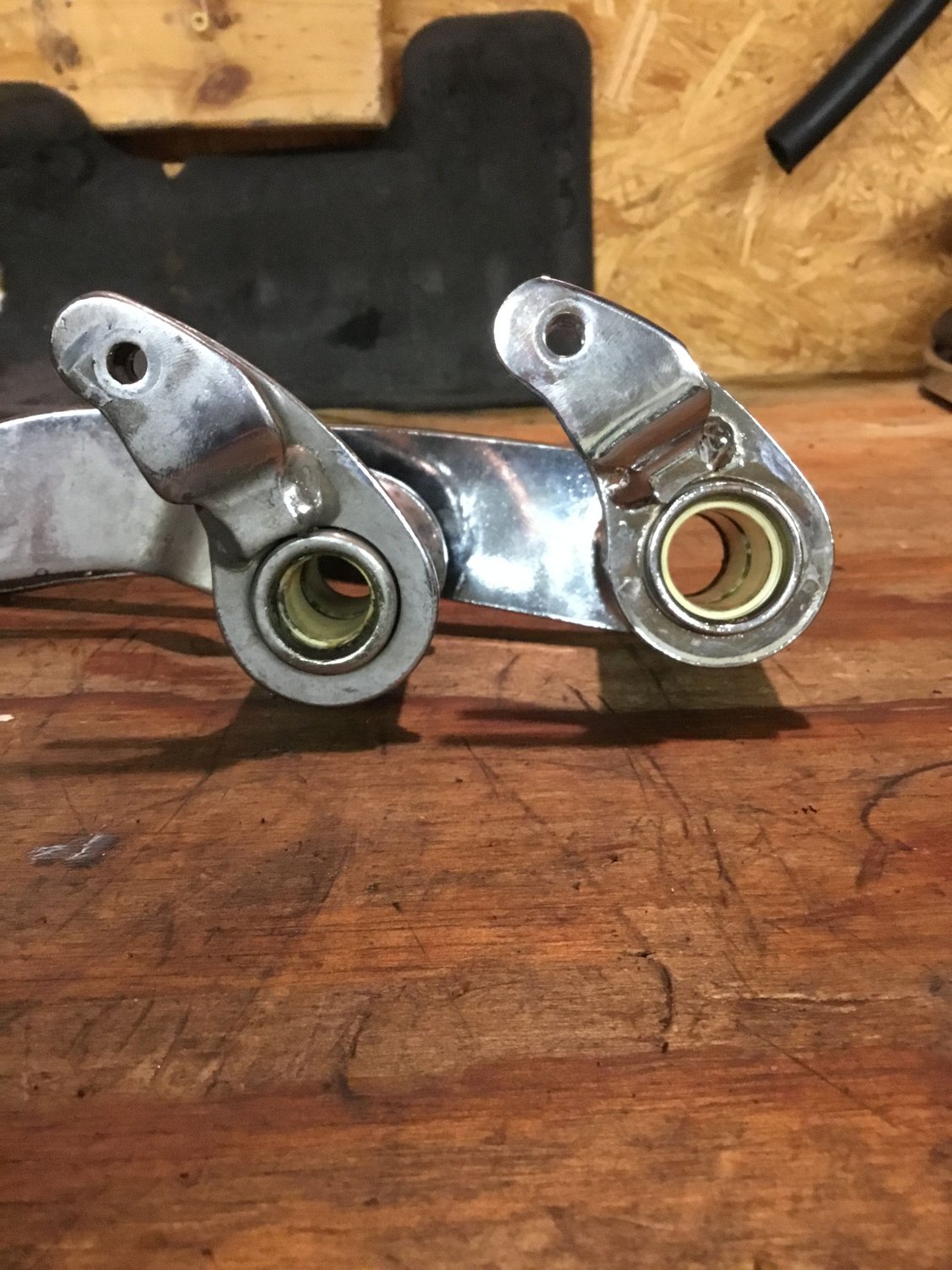

I’m going to try changing them when I get time. I think they just changed the angle of the arm. You can see the bend in the 09 arm. The 14 up arms just angle out from the base. They end up placing the brake pad in the same location I believe.

The shaft on the 14 up bikes is larger. Other than that they are the same. Hope this helps someone else.
14 up lever on the right. Hard to see but slightly larger bore.
