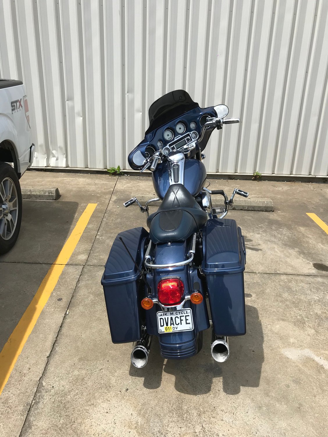

Ok guys I have been hunting for backrest docking hardware I have a 2008 Street Glide and I am being told I need different docking kits by multiple people. HDs kit seems like placement would be wrong do to location cam some one please show me the kit I need and pix to understand how it works

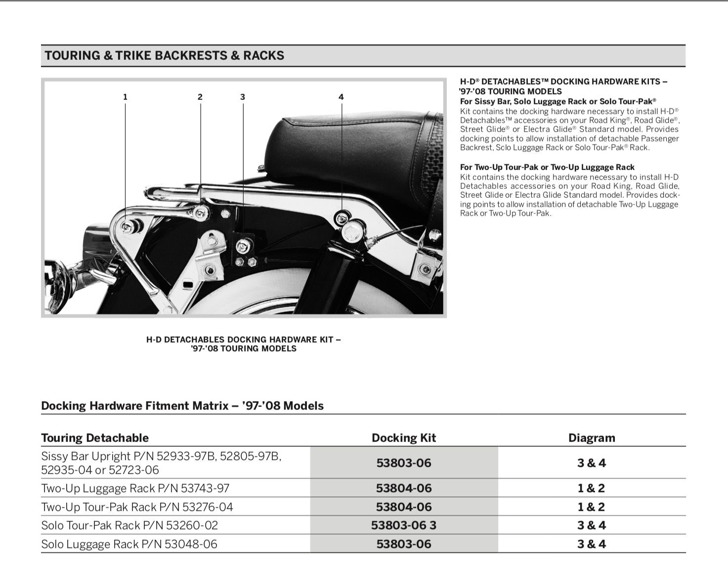

Depends on what you’re installing. If you’re installing a tour pak, you need 53804-06. If you’re installing a sissy bar, you need 53803-06. If you will be using both a tour pak and a sissy bar when the pak is off, you need both.

So just a backrest I need the black kit that bolt near shock tower and then above rear back mount?
HD shows both kits and they gave me the tour pack mount number as the one I need.
So so even a real person at HD isn’t always right. Thanks Dawg for clearing it up!
Yes
When in doubt, check the docking kit matrix
