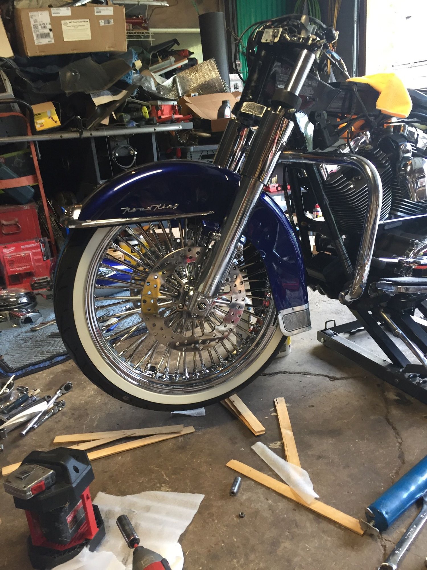

So I recently purchased chrome fork sliders and rebuilt my forks On a 2007 Road King classic.when putting them back together I of course torqued everything to specs but afterwords realized that my torque wrench was reading wrong and I snapped off the bolt and in the case. Anyway I’m wondering If instead of taking the complete fork out of my 2007 road king can I just pull the damper bolt and replace it or do I have to completely take out the spring to release pressure? When I say damper bowl I mean the one with the copper crush ring at the bottom of the fork. I’m afraid I over tightened them and they are going to end up snapping . Please let me know

I appreciate your guys help. Just an update I was able to take the front wheel off pulled the bolts out let the fluid drain put the new bolts in and torqued them to spec filled up forks from the top without removing them once again. And yes I did way over tighten those bolts they were stretched Almost a 1/4”...thanks guys
