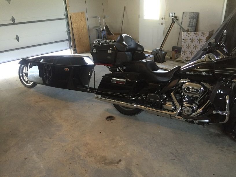

I added a N-Line trailer a few years ago, LOVE that little gadget, but REALLY sucks when end up in a back in or pull in back out parking slot during trips. I admit to it, am getting old and legs do not like me much anymore, Lower Back is become a MESS so figure to gain a little thrust to weight advantage when do get locked into a corner.
