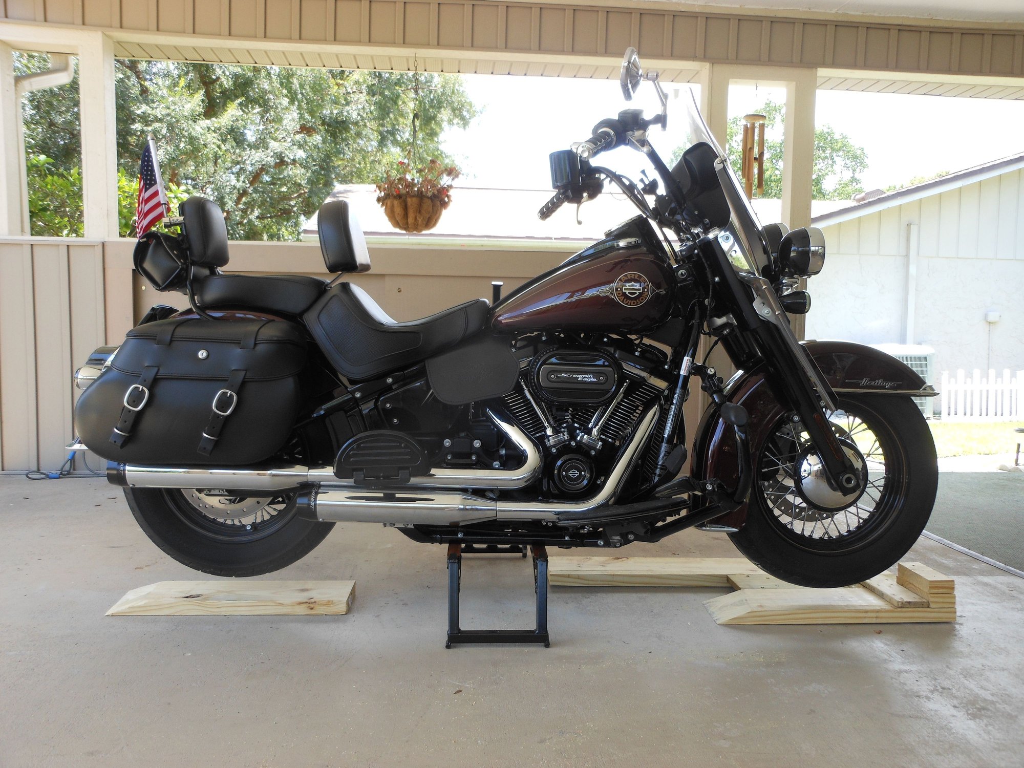

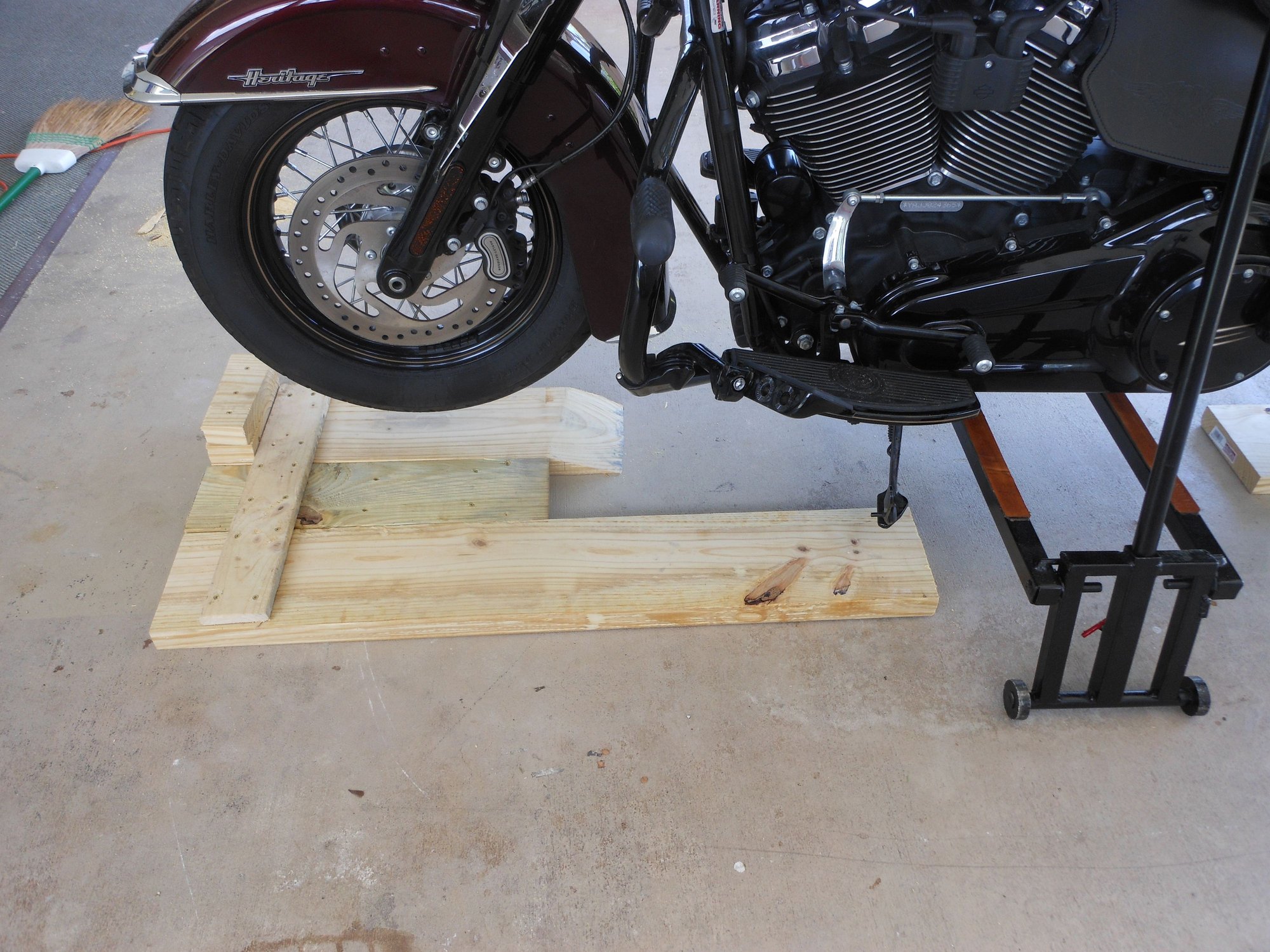

A simple piece of 2X8 with a sloped cut on one end will allow you to roll your rear tire onto it and give you room to slide the jack in and out with any problem.
Both my Cherry and Big Sister have been lowered front and back and my jacks will not fit under either. So, I made a set (originally for Cherry) of 2X8's with the sloped ends for both the front and rear tire to roll up on. The front has a wheel stop on the opposited end to the slope cut and I made an outrigger that the jiffy stand can land on so the bike doesn't lay toooooo far over when up on the 2X8's. It works for big Sister as well, but had to modify the outrigger to suit the jiffiy stand that extends out nuch further.
Here are a couple of Pics showing Cherry on my V-lift jack with the2x8's below (I don't have any pics with Big Sister):
Cherry on the V-lift jack. Works great for oil changes and detailing.
Note the outrigger for the jiffy stand.
I also have a HF jack stand, but the V-Lift is much more stable but does not raise the bike very far off the ground.
