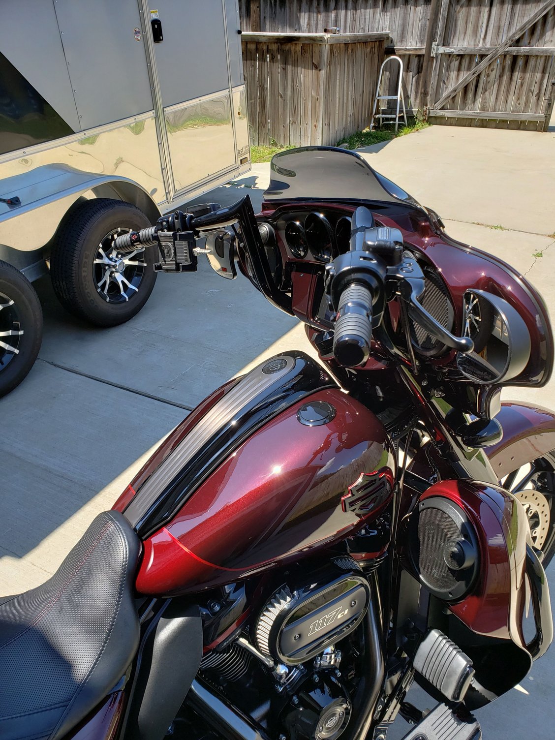

Stripped it down to the bars this evening, removed the stock bars and pulled the wires out of them. Got the throttle side done but did have to de pin, now I'm stuck on the left side because of the heated grip plugs, 2 on that side and then the control switch wire. One of the grip plugs seems too big to fit through and cant seem to de pin it, I will keep plugging away .

Got it all wrapped up! All said and done I am very happy that I did this job myself and saved a chunk of change! Would not hesitate to do another. Factory 47's video carried me all the way through so big thanks to them! Ride safe brothers!
