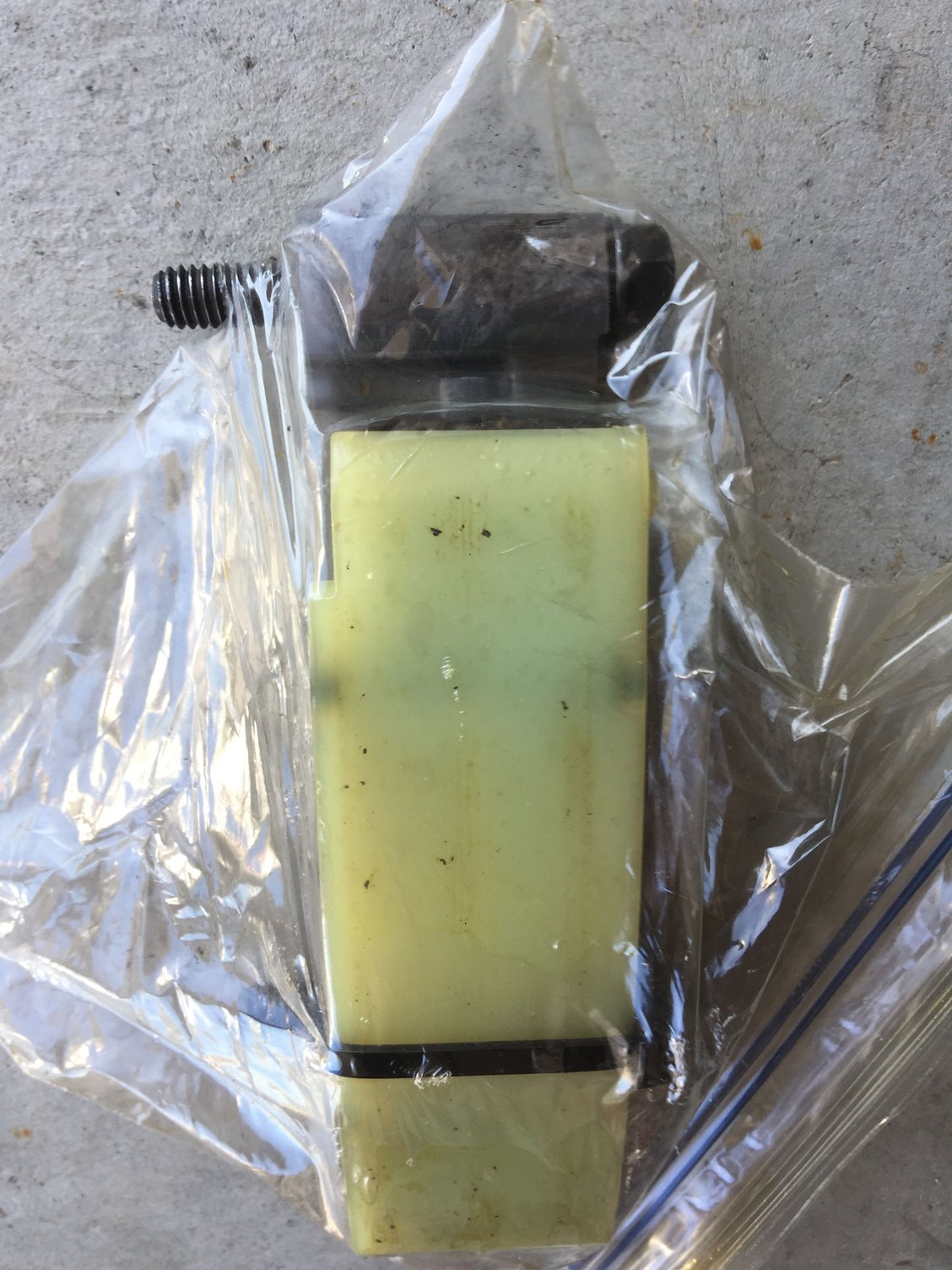

Years and years ago, I replaced the stock primary chain tensioner with a Hayden M-6 because everybody else was doing it. Ha! It appears as though the springs have lost their 'springiness'. Decided to put the stock one back in. Practically brand new so not a problem. I could f'n swear that there were two spacers required for the stock tensioner that were not needed for the Hayden. My trusty manual doesn't mention them so I phoned the dealership. Gal behind the desk said 'no such thing'. Have I lost my mind? I'm only 62 but vividly remember handing the spacers to Pamela Anderson for safe keeping. Thanks for all replies!

I went to a Hayden too, I don't remember any spacers on the stock tensioner. Are you thinking behind the tensioner against the inner primary case? Pretty sure it mounted flush to it, nothing in between

Just looked at Ronnie's parts drawing and their were no shims listed for the stock tensioner (p/n 39929-06B). Did you try to contact Hayden for the shims or new springs, I remember Hayden had a batch of springs too tall and I got the right ones with an e-mail.

There are two round spacers that have a locating lip that fit into the back side and then the bolts go through everything. That’s how my ‘09 is.
You remember them because they always fall out when you are trying to install it.

Yes to thinking that there were spacers between tensioner and inner case. Also heard that Hayden was very good about replacing too tall springs but haven't contacted them. The racket just started yesterday and I thought ...oh sheet...another compensator or inner primary bearing....efff..not the SE Clutch etc etc . Took the cover off and the polyethylene body of the Hayden was smackin off the primary housing causing a rat-a-tat-tat sound. I'll get back to you guys.

Yes, cncmike. The 'inner' side does have a lip. I'm guessing that both spacers are the same dimension.

39929-06A is what I have. It superseded 39929-06 which, in turn, was superseded by 39929-06B.

Do yourself a favor, junk the #39939-06A tensioner and pick up a new #39939-06B tensioner.
The "A" tensioner is the reason everybody was switching to the Hayden primary tensioner. It would frequently over tighten the primary chain, which would then lead to collateral issues with damage to bearings/seals in the primary and/or trans...
In this pic, the "B" is on top and the "A" is on the bottom... you can see the "B" just looks like a better piece... The "B" has a thicker base for less flex, smaller teeth for smaller adjustments, and the shoe portion only has a small section of teeth (unlike the "A" that had teeth all along the shoe base). These changes have pretty much fixed the over tightening problem..... there have been very few reports of an overtightened primary chain with the "B".... unlike the "A"...
PS- popular topic, that's the second time I've posted that primary tensioner pic tonight.....
