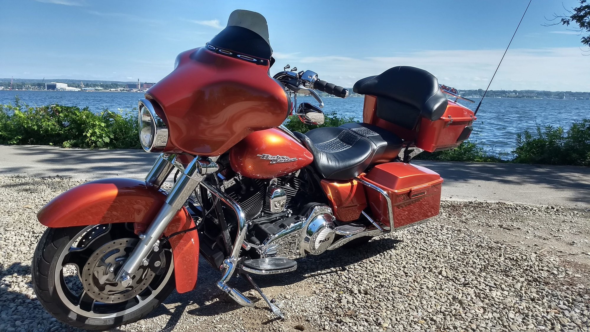

This is the HD visor ring with a TruckLite headlight. I also used it with a dual bulb halogen headlight. Some fiddling and it fits just fine IMO. Do I wish it mounted as simply as the factory ring? Absolutely.
