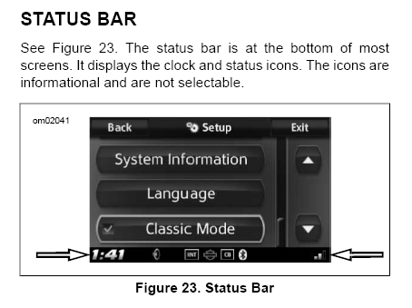

Sounds like you may have the Intercom turned on with the intercom volume off. If this is happening, you will have a visual indication on the status bar. There are other possible causes, but let's start with this.
