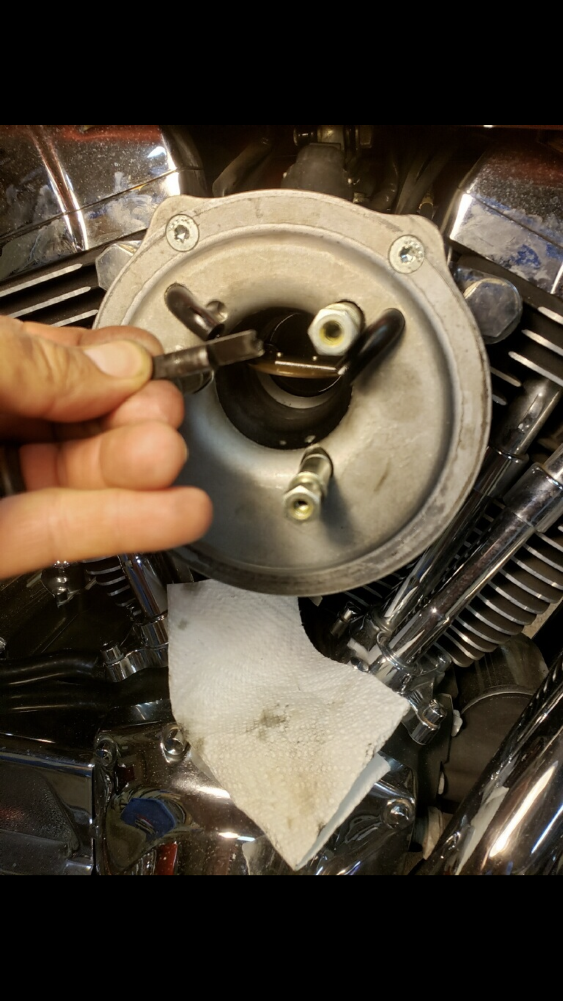

Well finally found problem with my bike. Will attach picture. Had code for Map sensor. Contacted Harley. Said i needed new throttle body. The rod that holds butterfly valve broke. So I’m having a problem finding a takeoff throttle body. My bike is a 2004 Ultra Classic FI. So if anyone has any leads. Please let me know. Thanks

Will a 2007 ultra throttle body fit a 2004 ultra.

I just did a quick check and saw there are several used and new Delphi throttle bodies that will fit your bike on flebay for less than $100

The ones i had seen. Didn’t look like the one i have. Guess I’m looking in wrong place.

You can always buy a new throttle body assembly from a dealer. Here’s a link to a page showing the part you need. You need part #6.
http://partsfinder.onlinemicrofiche....ION%20ASSEMBLY
