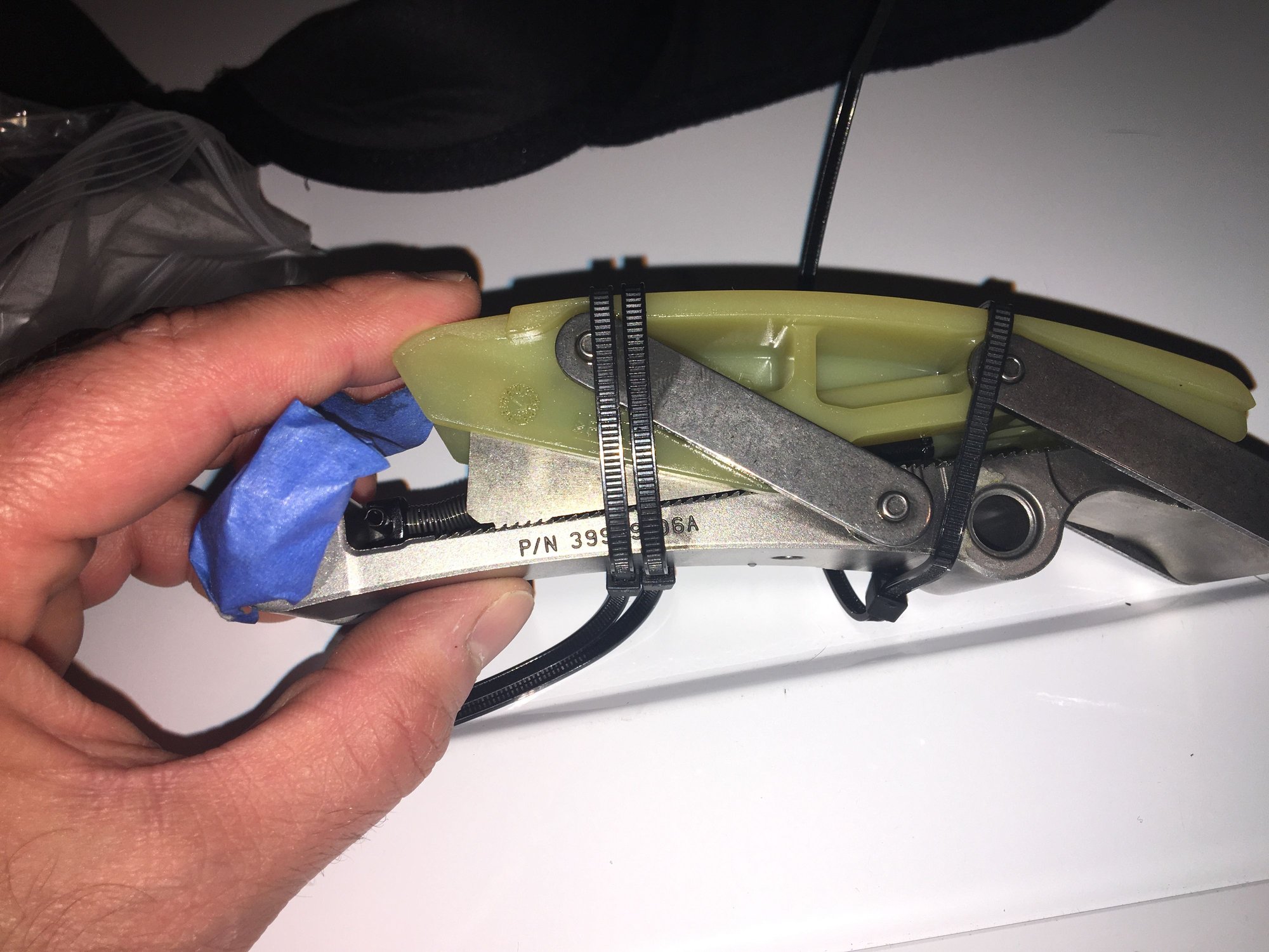

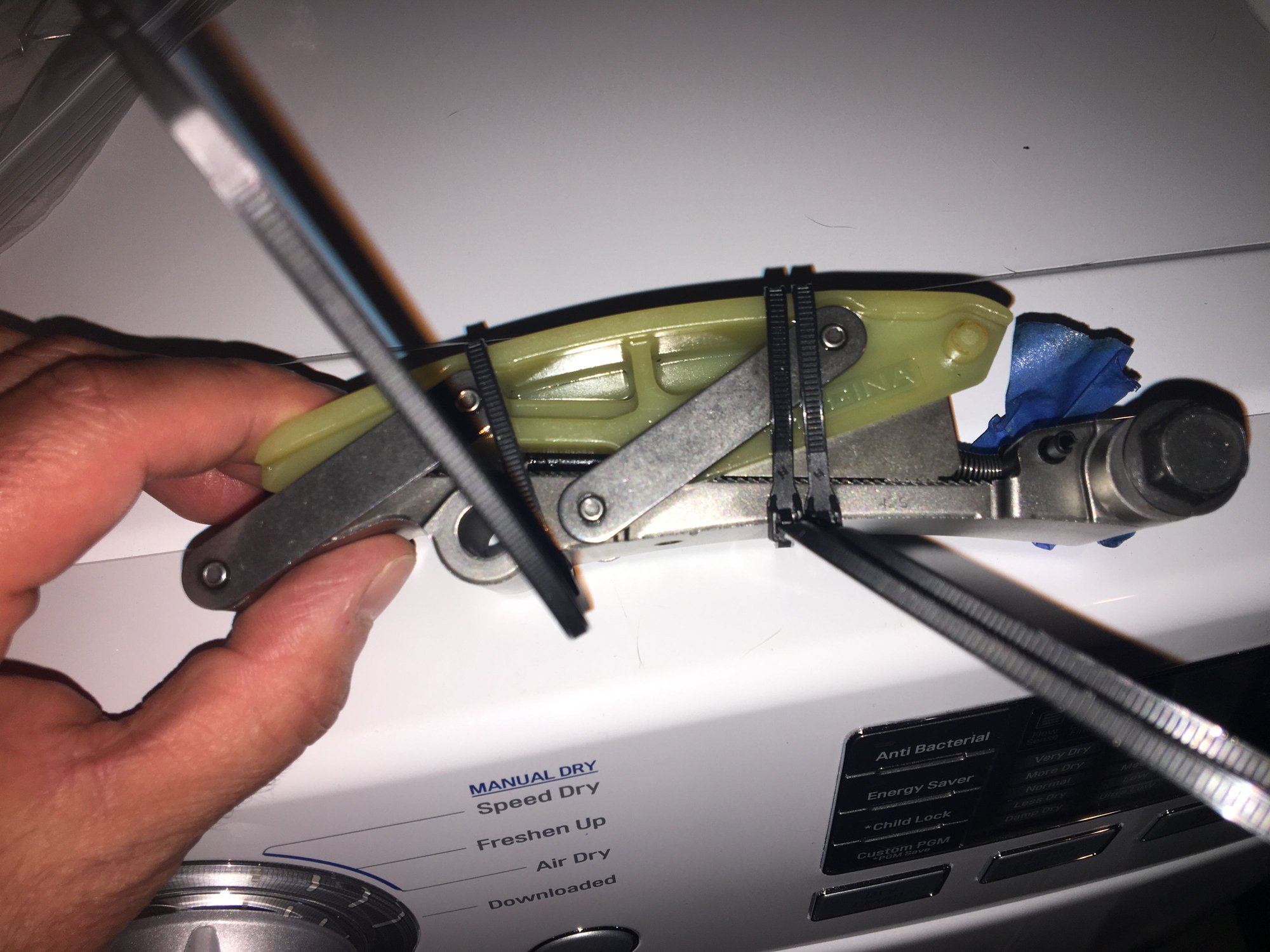

I just pulled my old OEM tensioner from my parts storage. Mine is the older "A" version but has the same characteristics of the "B"?

Wow,... thanks for that pic...!!
I'll have to go back and check my research.... that certainly looks like it has the best features of the the "B" tensioner....

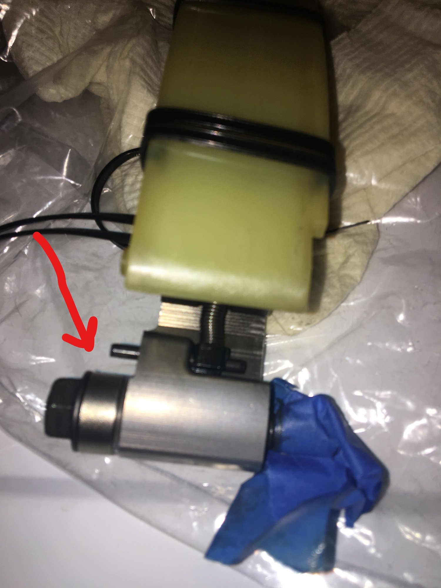

Whats this piece with my arrow?......

Locking bar. Remove after installing tensioner.

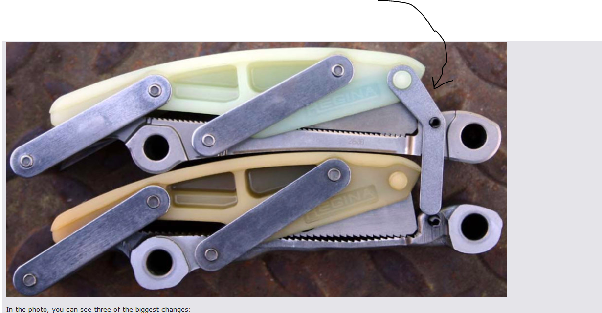

OK, here is what I found with some searching....
The link I saved, that discussed the changes in the tensioners, is no longer valid... I should have printed it out, but I just saved the link... lesson learned...
My pic was mislabeled..... I had it labelled as an "A" vs "B".... it is obviously the original '06, that they dumped quickly due to many complaints/failures, compared to the "B" or maybe even an "A"... not sure at this point...
Your pic is showing the "A" model, I had believed was changed in '07.... I can't now confirm when the "A" improvement was made. All the parts fiche now show the updated "B" part, not what was originally used. I don't happen to have an original '07-'10 parts manual. My oldest original parts manual with that tensioner is my 2012, which already shows the "B" as OEM...
Here are some "A" to "B" model comparison photos....
"B" is on bottom
"B" is on the left
From what I can see comparing the "A" to the "B", the width of the mounting base had changed. The "B" is a little larger than the "A", so the spacers are no longer needed for install. Not sure now, without my reference link, if that is the only change between the "A" and "B".
The only thing I'm sure of at this point, is that the "B" improvement has had a failure rate much less than the prior versions......
I appreciate the pic that set me straight.... I try to give good info, but sometimes my memory, and/or my note taking, isn't infallible...!

Just went back to the parts bag and you nailed it. You can see the difference in size as well as the spacers. The spacers install on the back side if I remember correctly.

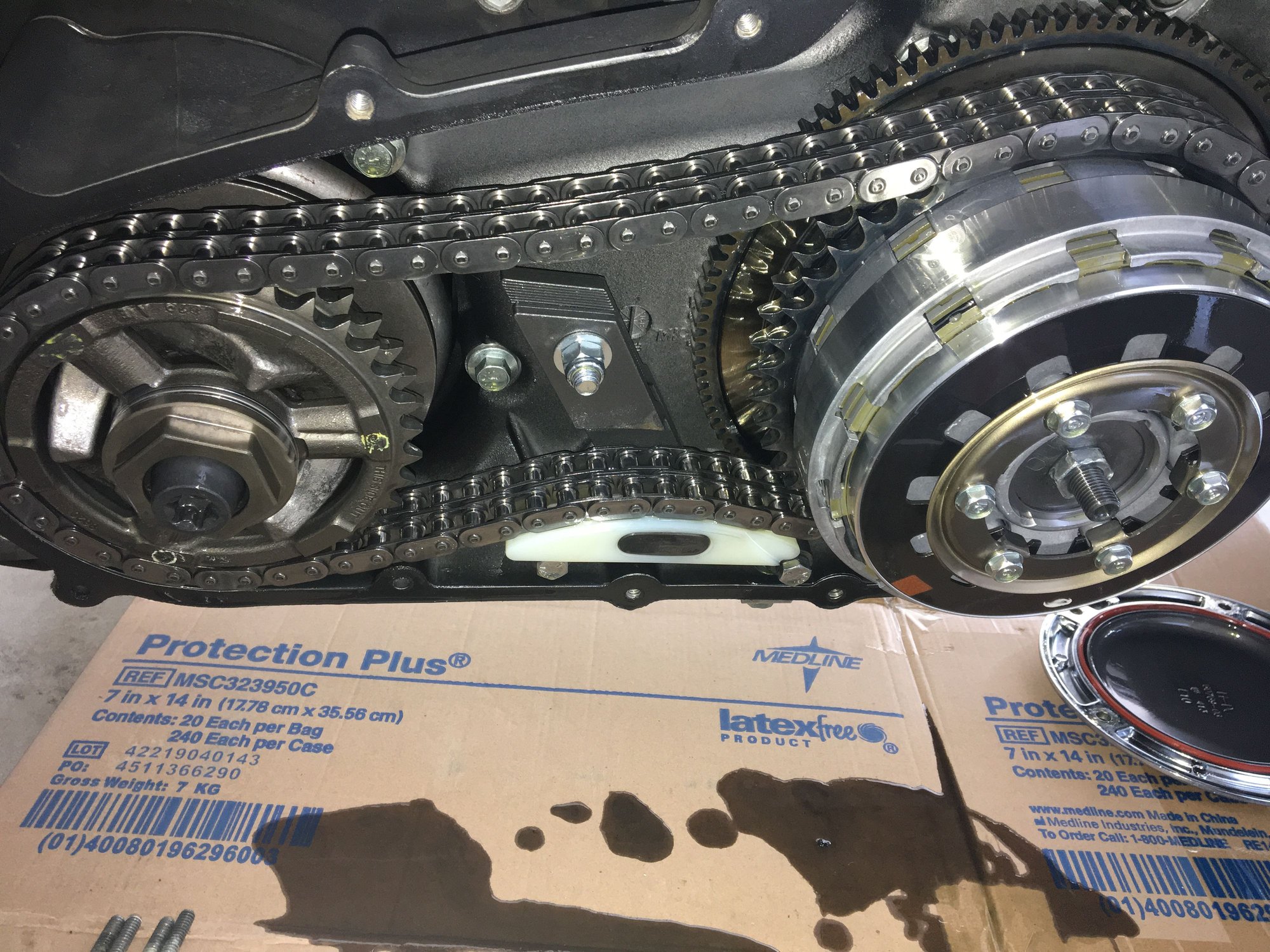

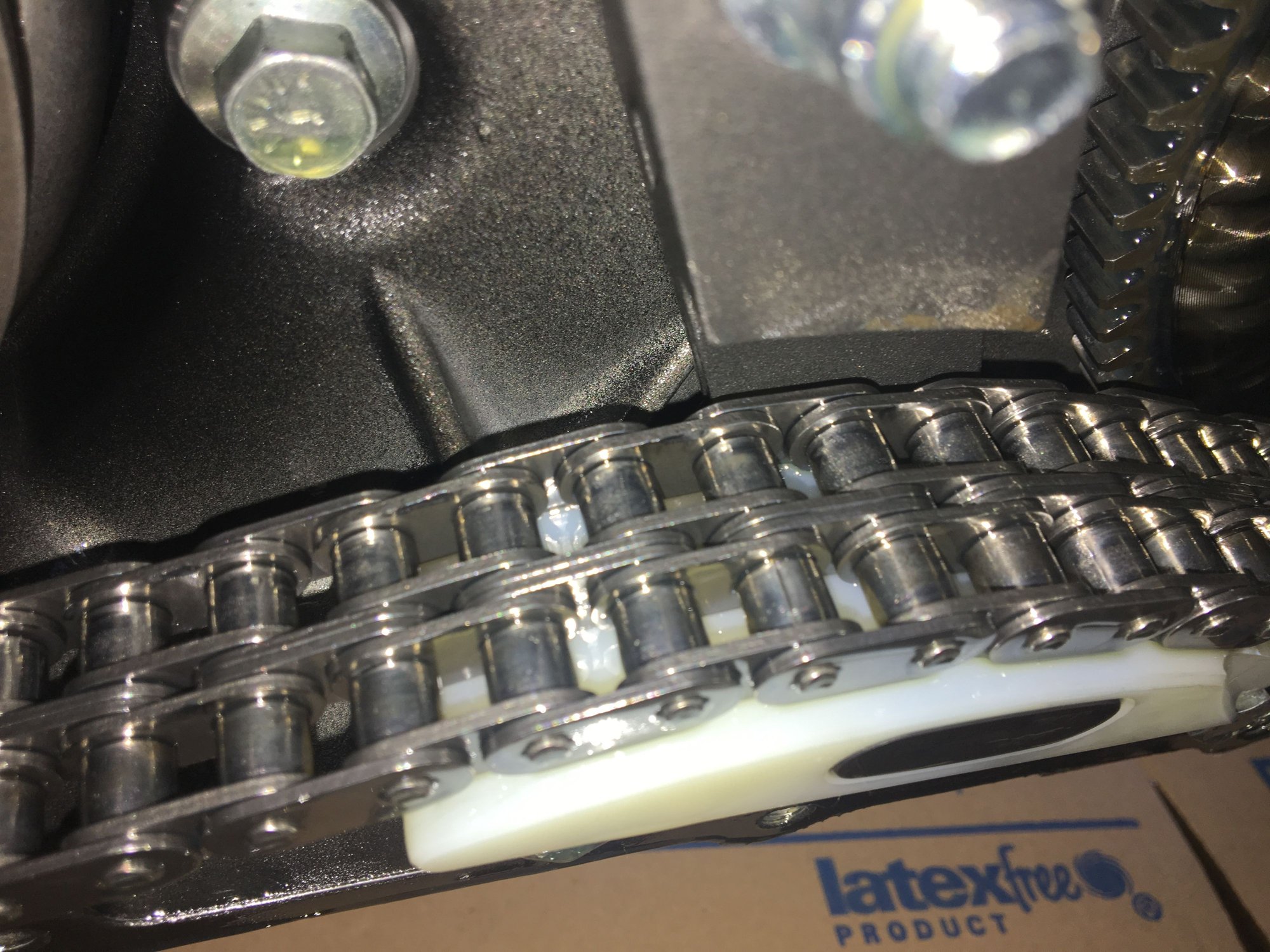

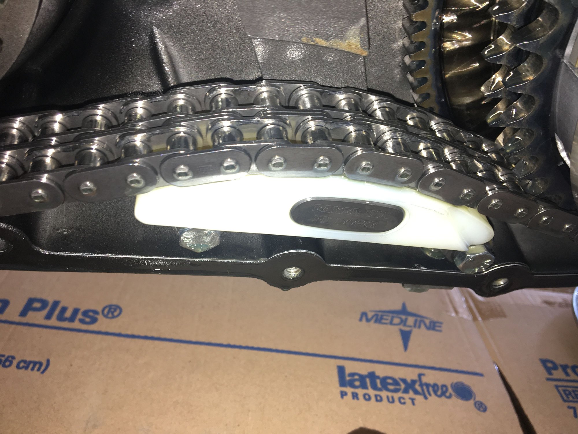

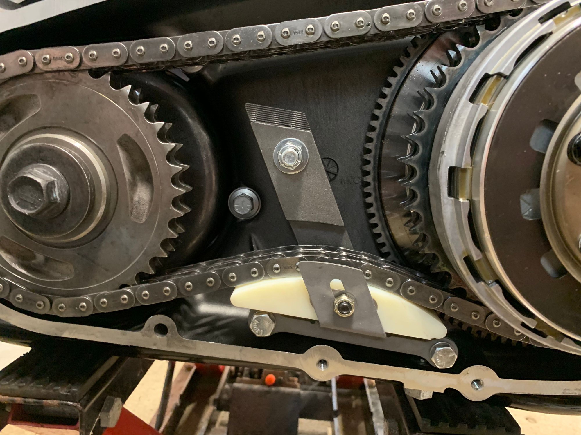

I've had the Baker in my bike for 5+ years and upwards of 10k for miles on it. I've never once opened the primary to adjust or inspect. Believe it or not it was on my list for off season maintenance. This thread got me thinking so I decided to pull the primary cover and inspect ASAP.
The unit looks brand new, the shoe looked beautiful and had practically no markings at all. I reviewed the Baker video on adjusting the chain tension. I checked several spots and it was all in spec. The unit required no adjustments.
