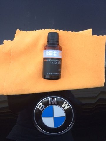

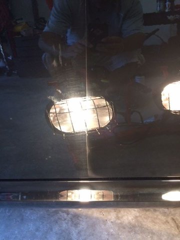

Blankline, Looks much better. If you want to get before and after shots do the 50/50. All it takes is a piece of painters tape. I do this for every vehicle I do and send it to the customer. Ill attach an example, which is only compounded, no polishing. Next 2 are final results. As you can see in the blurry letters on the coating bottle, camera phone was sucking!
Im not a chemical guys fan, never could get the results I was looking for with there polishes and compounds. Soaps are good though. Whatever works for you is what's important.
