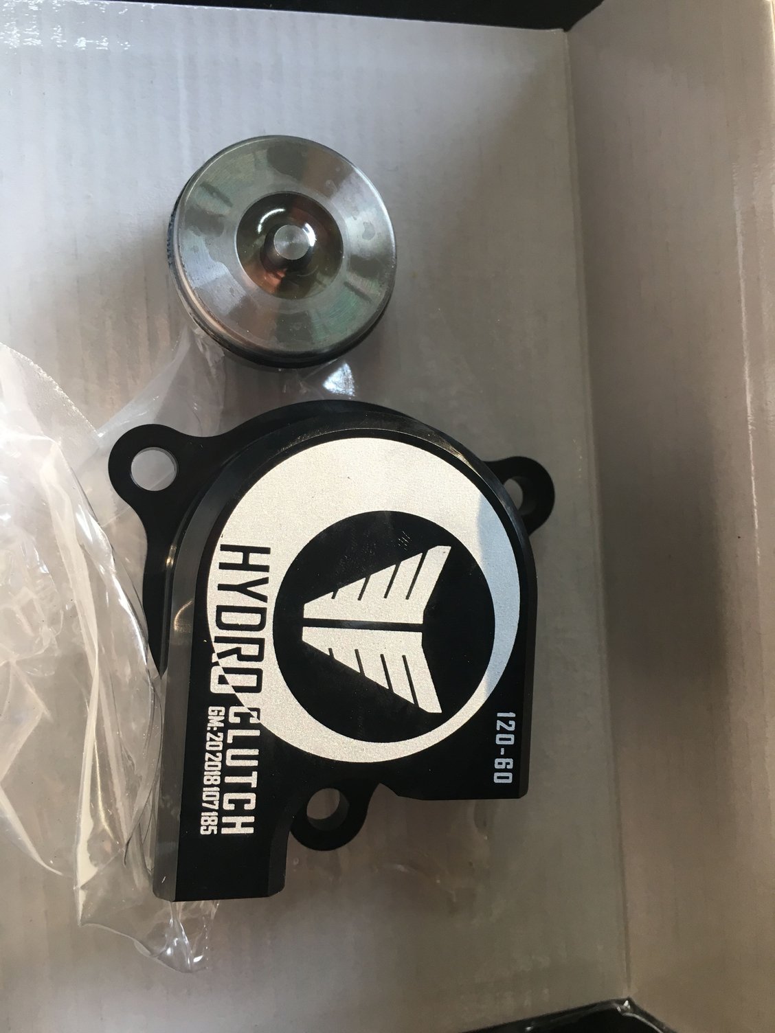

Just FYI..... other than the AIM combo slave cylinder & master cylinder kit for '14-'16 hydraulic clutches...
There is another player in the field, the Muller AG 120-50 Hydro Clutch Slave Cylinder for '14-'16 Harley Touring bikes, made in Germany. It is just a slave cylinder, cheaper than the slave/master set up from AIM, and claims 35% less pull than OEM...
Looks promising, but I haven't seen any reviews on it yet...

Solved mine with the Muller Hydro clutch. Went with that one over AIM due to all the problems AIM has been having with their unit. Makes engagement right off the grip and pull much easier. Mine uses the -160 unit. Yours would use the -150 unit. Have had mine in for 6000 trouble free miles.
That unit fits the 2019's?
I'm looking for a unit for my 2019 Ultra.
Yes, I have a 2019 with a 120-60 Muller unit for 2017-2020 fitment. The 120-50 is for 2014-2016.
https://www.easternperformance.com/m...-twin-cam.html
Dennis Kirk also has them as well as 2wheel.com. I purchased from 2wheel. When I bought mine, they had the fitment reversed. Not sure if they straightened it out yet or not. Also purchased a speed bleeder to make bleeding a snap.
