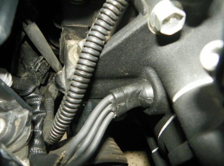

Just a random pic for example. Not necessarily an FL touring bike.
Welcome to the leaky stator grommet club! Think of it as a trophy...a badge of honor...an indication that you actually ride your bike. My 2010 Ultra leaks like a mf'er from here and has marked her place all over my garage floor and anywhere else we visit. I will probably give her the ol'e college try to seal her up with black RTV after a good cleanse with brake cleaner but that seems hit & miss at best. The real problem here is that I am a cheap bastard and refuse to replace a perfectly good stator just to acquire a new grommet (cannot purchase separate). Would you believe me if I told you "they all do that".....guess the grommet dries with age and shrinks or hardens/cracks. Yup! It's a Harley and true to form she marks her place and claims territory. I like to think of it as corrosion protection for the undercarriage between washings and I ride on!
