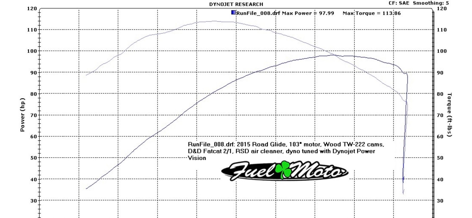

Would love to see YOUR rankings in black and white. Based on touring vs. this Dyna. To me, it seemed like the S&S 583’s, mr103’s, Woods 222’s and Andrews 48’s, were best for touring. With the later 3 being nearly identical. The big disappointment, to me, was the 570-2’s. I honestly thought they were going to beat everything. I was, however, very surprised by S&S! But, also a little disappointed in my 222’s. In your earlier tests, with a Fatcat, the numbers were slightly higher.

The CycleRama 570-2 works great with the right combo of Exhaust and Breather in a TOURING BIKE !!
