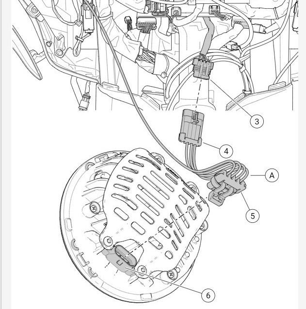

After reading the replys, I believe there may be some confusion. The back of HD's Daymaker does not use the H4 connector found on aftermarket LED headlights.
The adapter (A) is included in the kit when purchasing a Daymaker from HD. Replacement adapters are available (HD part # 69201775).
There are a variety of less expensive Daymaker "knock-offs" that look identical to HD's when viewed from the front, but the back has an H4 connector.
There are also less expensive aftermarket alternatives that outperform HD's Daymaker.
