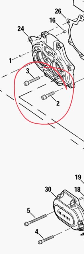

Slight leak of transmission fluid. Either transmission cover or where the cable goes thru the cover is my guess. Is there a seal for the cable at this point? Could the cable be loose at this point allowing a slight leak?

Check the bottom bolts that hold the trap door on as well. Known to come loose.

But yes, could also be the o-ring on the clutch cable where it enters

+1 on this. Those bottom bolts are notorious for loosing up just enough to leak a little. There is an o-ring on the end of the cable that could leak, but the bottom bolts are the most likely culprit.

Are you referring to the cover?

No, not the cover itself. The bolts just on the bottom of that.
