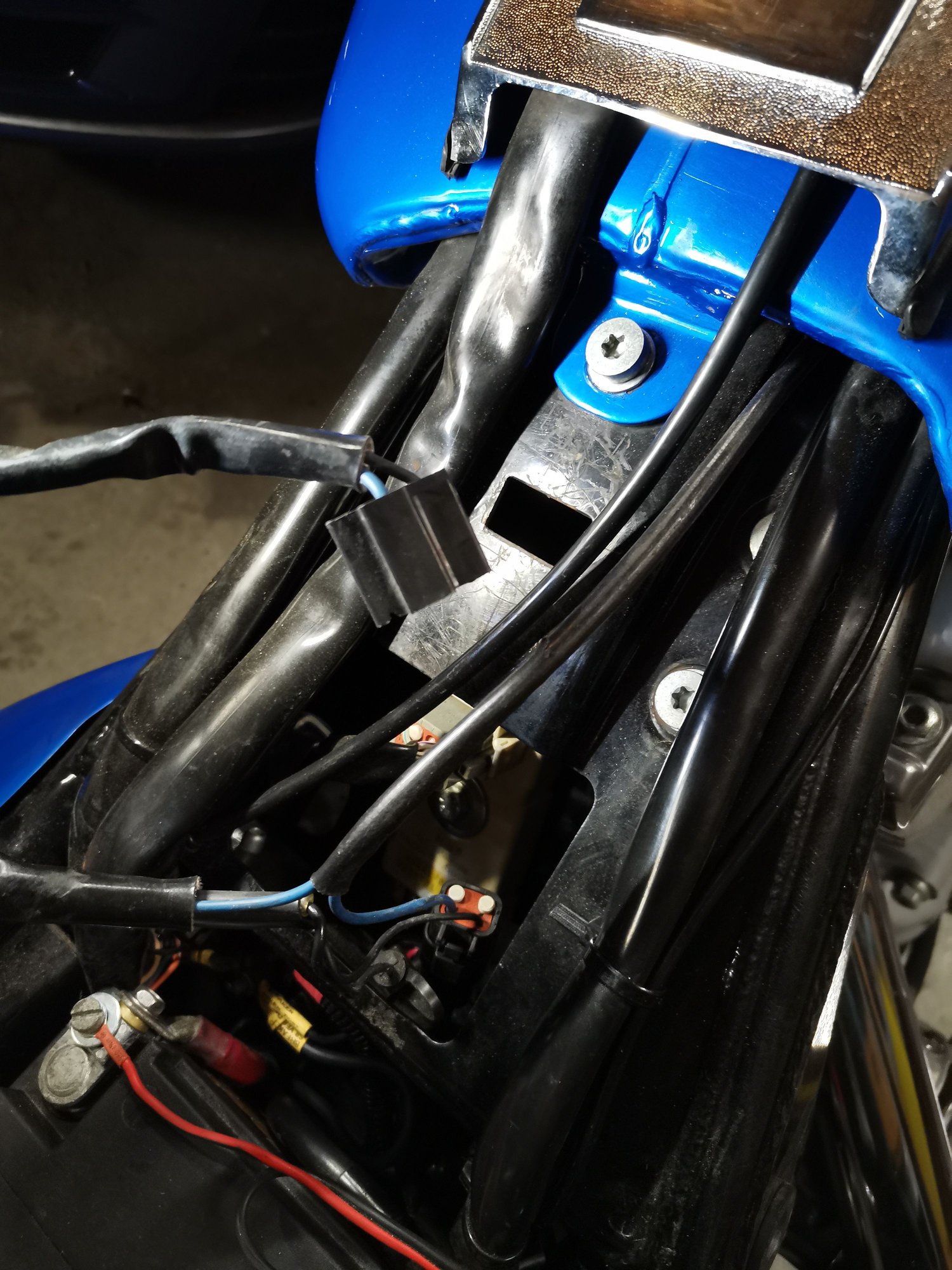

Those numbers keep coming up as proximity sensors, though none visually match that one.
You're going to have to chase the wires through the harness to see where they go, to better figure what this is. I don't see it as OEM on the parts diagrams, and know of no purpose for a proximity (or pressure or temperature) sensor there.
That does not look typical aftermarket. Better pictures around the sensor to see all the numbers would help. As well finding where the wiring goes too.

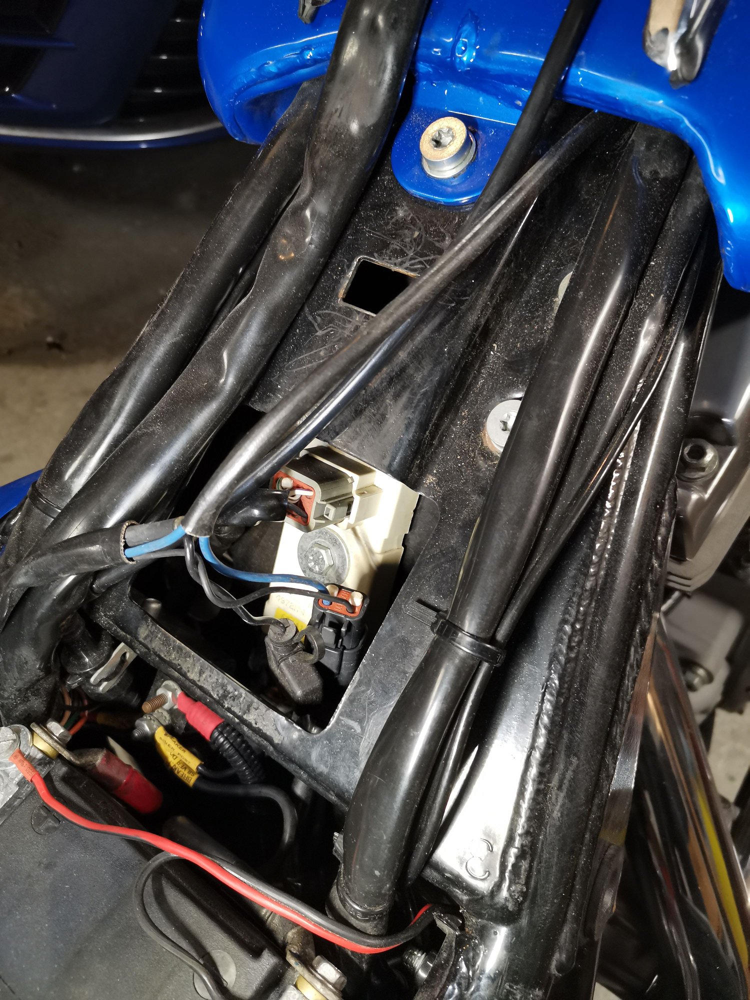

The 2 wires go into that connector on the right, and than into the main harness that goes to the front of the bike, under the tank

Originally Posted by motorbtr
Could be a thermistor or thermal switch based on what I can see of the part number. Don’t know what he would try and control based on intake temperature, is there a cooling fan somewhere?
No cooling fan. This was a police bike if that matters, in Australia. Maybe there was some extra mounted on it, have no idea

Didn’t international models have both active intake and active exhaust? Could that be an active intake sensor?

There’s no hole in either the back plate or sensor switch so it’s not vacuum or pressure operated. Definitely thermal. Like someone else said maybe there WAS a cooling fan and it was removed.
