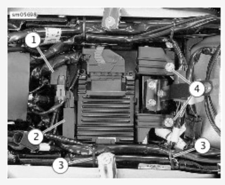

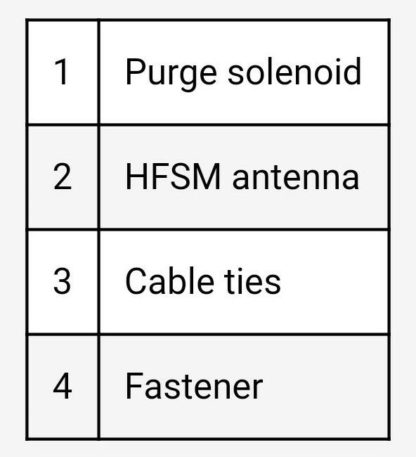

Look under the seat for the Hands Free Security Module (HFSM) antenna.
