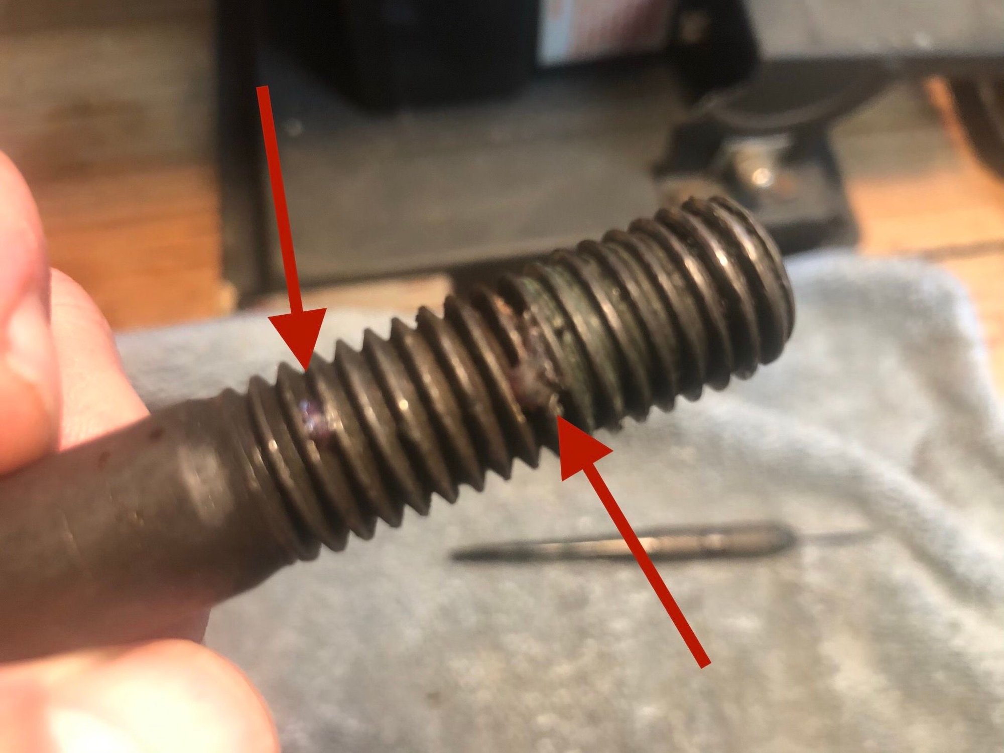

Is there suppose to be a couple small welds on the compensating sprocket bolt? (See image)
I tried to clean the threads with a pick and they wouldn’t budge. They look like a small tack weld - possibly to prevent over tightening?

Thats permeant red loctite. It will chip out. Not weld. Take a small V shaped punch and use a small hammer and tap it. Trial fit that bolt all the way to make sure it is clean and free and bottoms.
Clean all internal and external threads with lacquer cleaner. The preferably use loctite primer on them to finish cleaning process. Then use permeant grade (red usually) loctite on male thread. (Two lines). Torque correctly with sprockets locked.
Loctite only hardens in the absence of air but if you did not use primer, let it set 24 hours before adding the oil and running motor.
