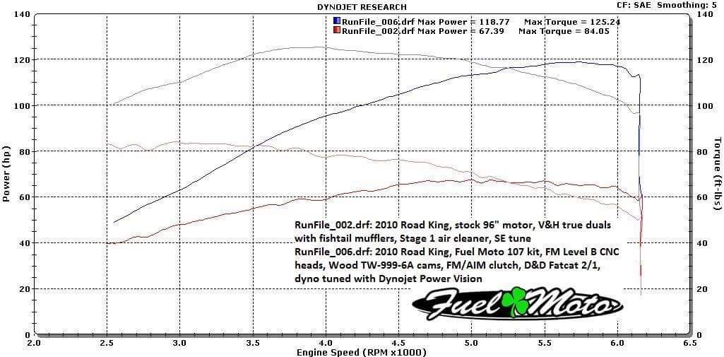

Please tell me I’m going to not have buyers remorse, for plopping down a small fortune on a big bore 107” and level “B” heads. I’m going with the Woods 999-6a’s and extreme duty cylinders. I really like the looks of the dyno chart. Anyone have experience with this upgrade? Do you wish you would have done anything else? Anything different? 110” instead? I want the best of all worlds; a reliable beast! That’s why I chose the 107” instead of the 110” I know Bob doesn’t get on here too much, but he’s always been courteous and patient with me. Often talking me out of buying something that would, essentially, be pouring money down the drain. This is why I’m willing to ride from Maryland to Wisconsin to have them install it. Simply put, I trust them. I’m scheduled for install, May 11th. Wish me luck with the weather. Anyway, here’s the chart I like!
this would be the exact configuration I will have, minus the Powervision I have a Thundermax and I have a 2015. I have the 222’s now, and love them, but I’m addicted, like the rest of you poor lost souls

If I had to do it again I would go big ( FM 124 ) another company that I dont see often is starracing /starpower they have a thrasher kit that also is uber reliable and puts out big #s

I have the exact build as the chart. I really like it, its deceivingly quick. Really smooth but all of a sudden you are coming up on 100 mph. I have over 22k on the build and absolutely no issues just change the oil regularly. It has truly been a dependable rider that if you choose to you can smoke the tires off it or just take a leisurely ride. Best of both worlds!
