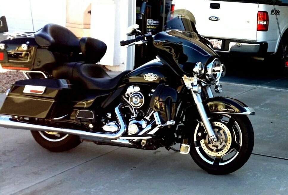

yep, there's quite a few 17" airstrikes currently available. I had no problem finding one dirt cheap for my 09 Ultra, I did the rear too, much better looking and so much easier to add air. Added some accents to them too:
