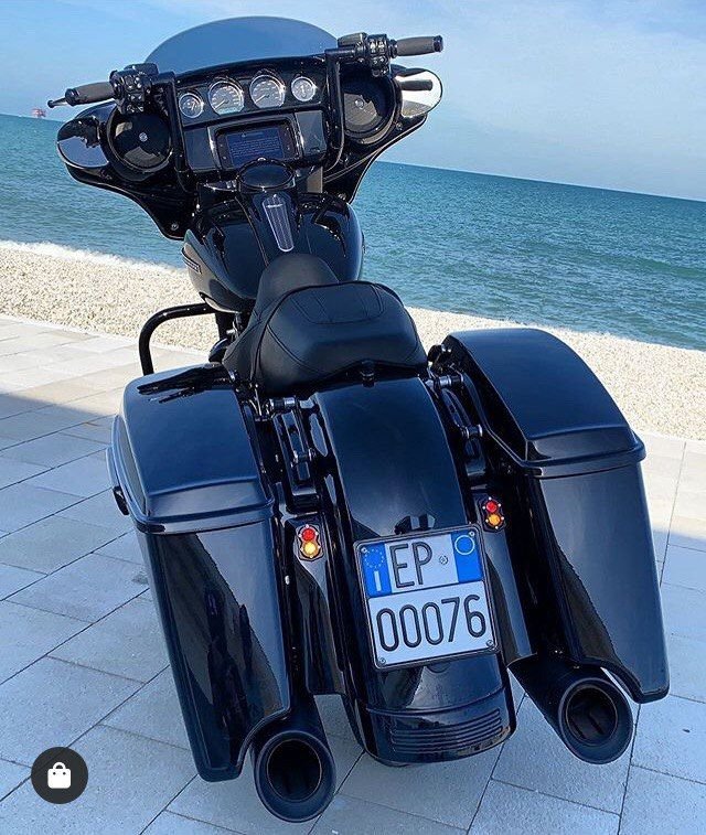

Hey buddies
maybe someone can help to find out what’s this bars manufacture ? Really like the view of this one! I think it’s 12” but cannot don’t exactly the same
Old Feb 16, 2020 | 06:57 AM
AlexBelarus's Avatar
AlexBelarus
Joined: Oct 2018
Posts: 131
Likes: 8
From: Belarus
I want to change my stock street glide 2014 bars to this one .
Resd a lot of threads here . So, I need this bars and extension kit for wires ?
Thanks for any help

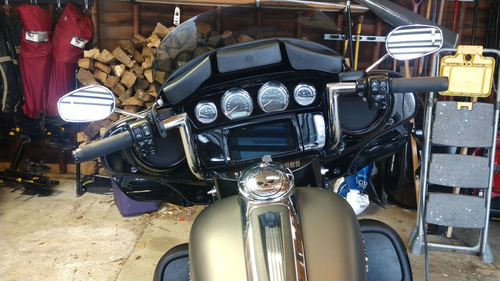

Old Feb 16, 2020 | 08:08 AM
dajogejr's Avatar
dajogejr
Joined: Aug 2014
Posts: 1,703
Likes: 909
From: SE Michigan
Alex, I did 10" LA Choppers on mine.
Dealer installed poly bushings for the bar mounts as well.
Any longer, the hydraulic lines would have to be changed. for these bars, just electrical extensions.
I'm just at the top of the bat wing so still a little protection from the elements.
Old Feb 16, 2020 | 08:45 AM
AlexBelarus
Joined: Oct 2018
Posts: 131
Likes: 8
From: Belarus
On my picture is la choppers twin peaks?
Old Feb 16, 2020 | 09:27 AM
dajogejr's Avatar
dajogejr
Joined: Aug 2014
Posts: 1,703
Likes: 909
From: SE Michigan
Can't say for sure, it's a very common design.
Looks similar but those in your pics are clearly 12 and not 10s.
You'd need wire and hydraulic extensions for the 12s.
Here's a comparable Pic from them
https://lachoppers.com/products/hand...12bagr-twpk-bk
Old Feb 16, 2020 | 09:51 AM
Cosmic Razorback's Avatar
Cosmic Razorback
Community Influencer
Active Streak: 30 Days
Posts: 21,645
Likes: 22,576
From: North Carolina
I have put both 10 inch and 12 inch on my bike. The wire extensions make it easier, the brake and hydraulic clutch lines are plenty long enough for the 12 inch. I had to re-route them inside the fairing but it was very easy.
