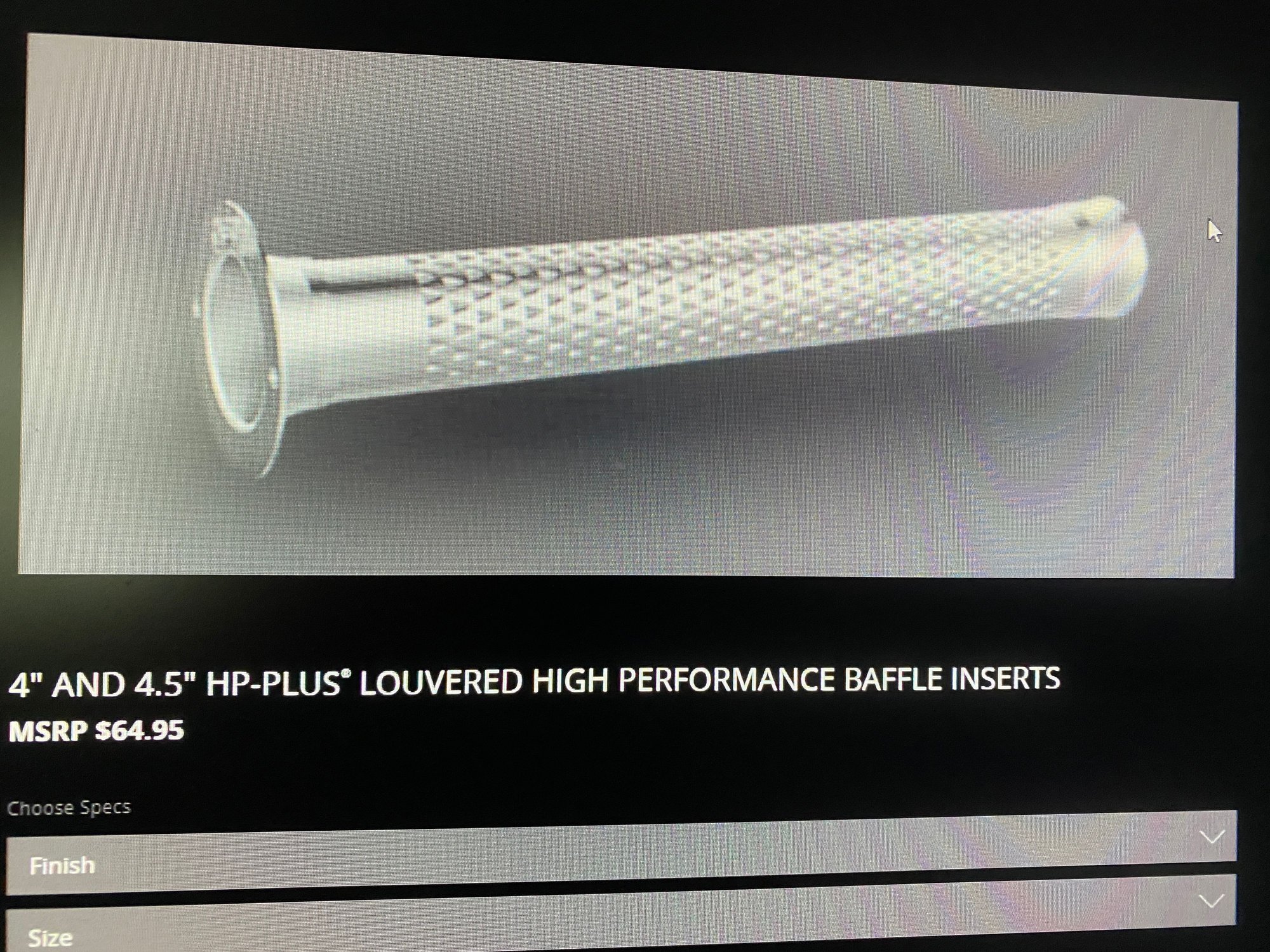

Default KW Hp PLus baffles
I stumbled across these louvered performance baffles for the 4 inch HP plus mufflers. I ordered them for $65. a pair.
