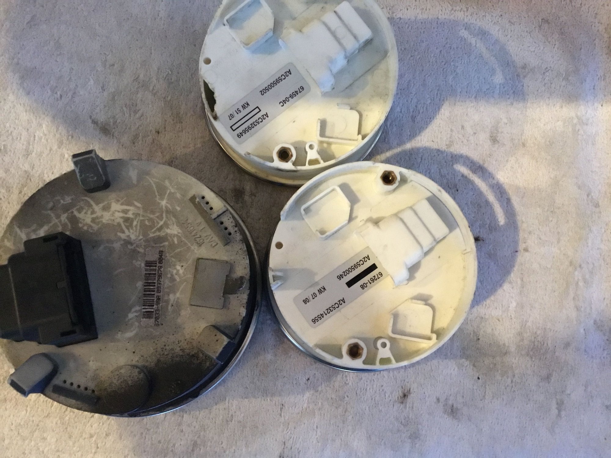

I have a 03 road king that was converted to a road glide I want to put the Road glide tachometer speedometer on the fairing the plug on the road king speedometer is different from the gauges I have
do they make a plug in adapter or do I have to rewire the gauges?

It appears you need the nacelle harness. It connects to the Interconnect Harness. Without know the details of your conversion and how it was done, all this is the best educated guess that I can come up with.
