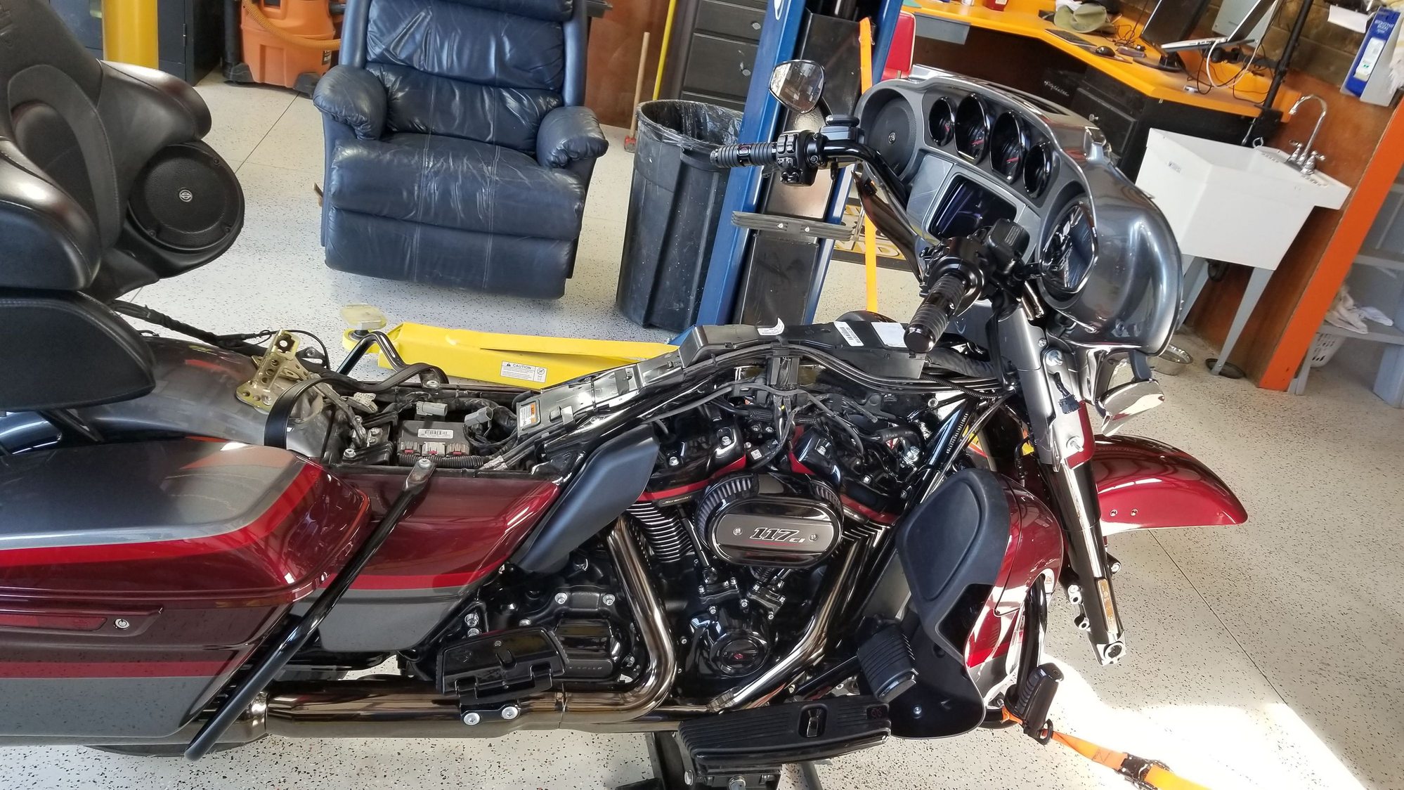

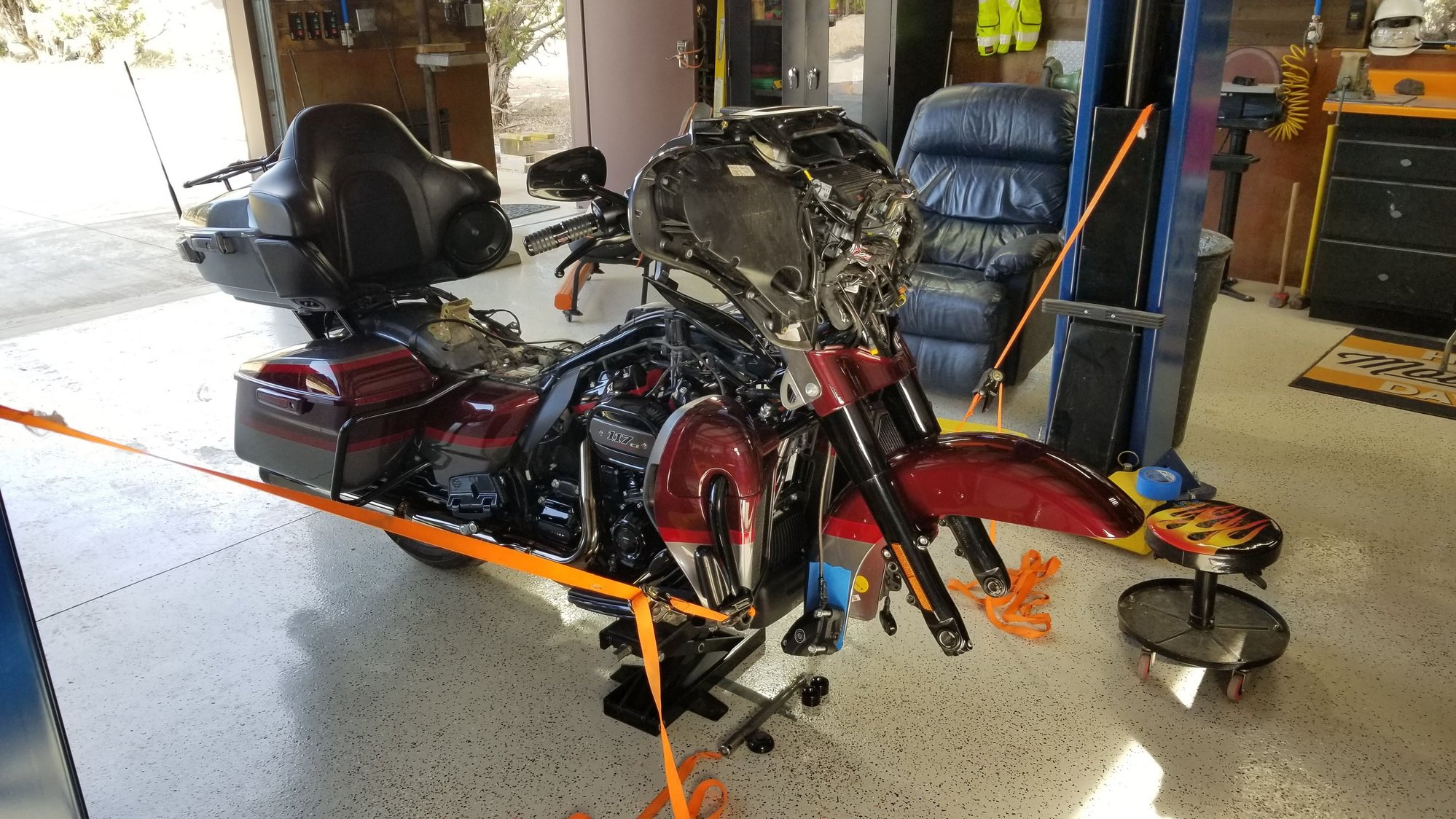

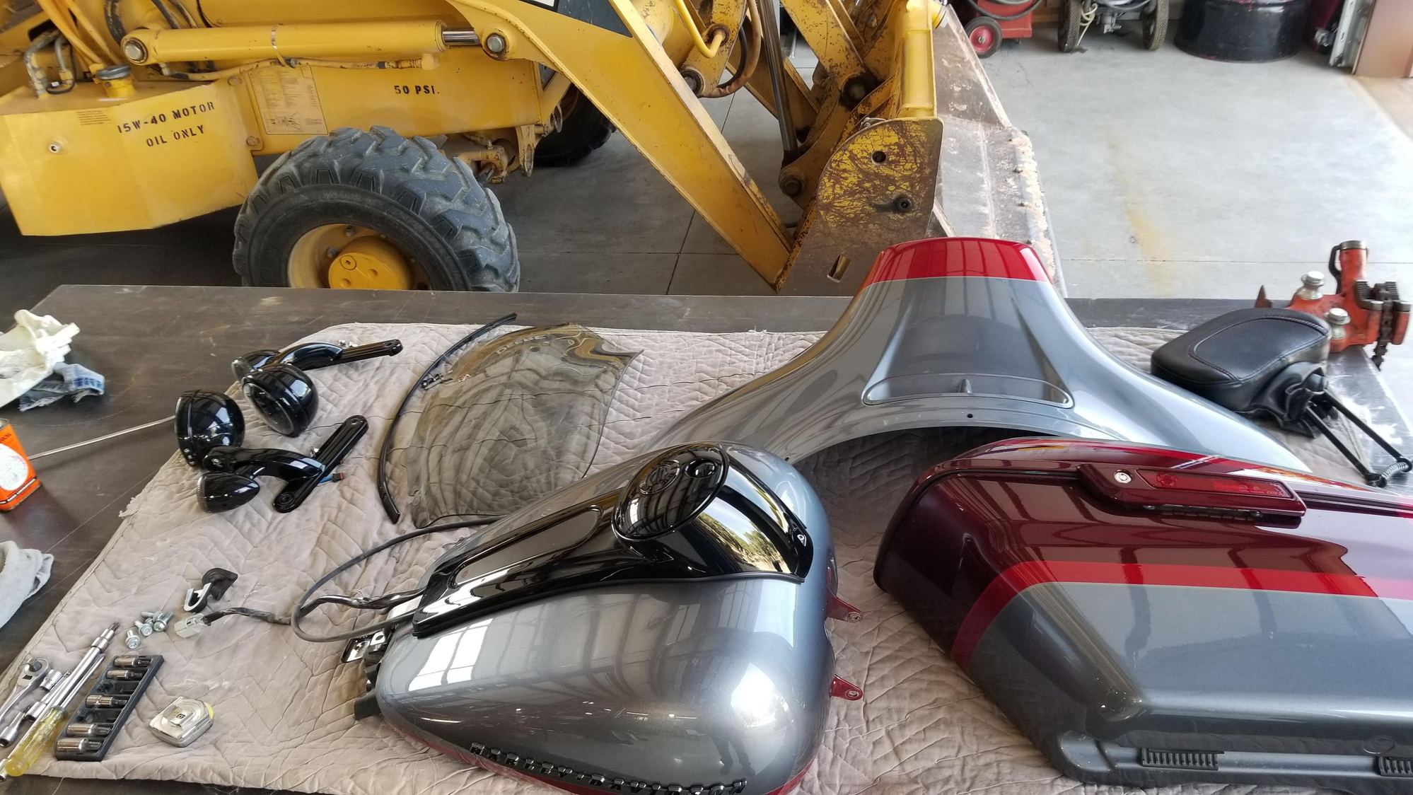

Sorry I didn't take any detailed photos, but with the new HD Android Auto released, I just had to do something about my big *** Note8 sticking out of the dash cubby...that **** wasn't gonn'a cut it.
I got a USB splitter and ran one end into the cubby and the other "skillfully and carefully" along the backbone and into the TourPac with the use of a 10' USB "A" to "C" extension cable.
It looks absolutely factory and works great! Now my frigg'n "LARGE" phone can homestead in the TourPac, rather than dangling around in the cubby.
It was a big job but the front wheel is off anyway waiting for a new tire from Rocky Mountain ATV.
I also relocated the Sirius XM to the top of the dash...we'll see how that works, otherwise it's going back under the fairing.

Unplug the factory USB from the head unit and the rubber plug in the back of the cubby pops out going the direction of the door. It is not bonded to the USB cable, I used an Xacto knife to split one side, peeled it off and used it on the new splitter cable, just fished it in. Ya have to use the OEM USB because of the end they use on the head unit. I sealed the connections with large shrink tube because otherwise they would not be weatherproof. I should have taken photos, but you get the idea...
