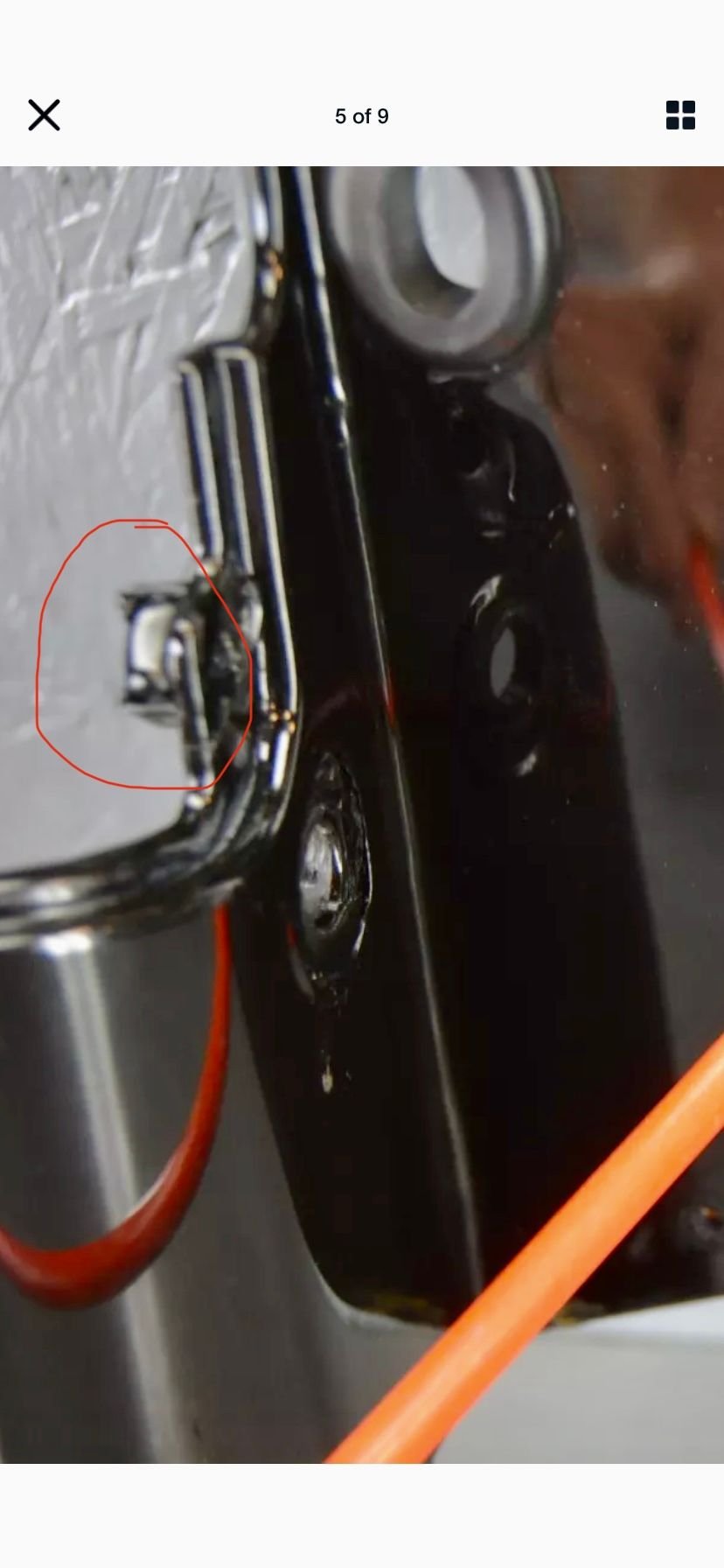

Here is a better picture of the spinning nut (circled in red on an uninstalled fairing) that I’m dealing with behind the screw holding on the lower inner fairing switch cap.
Can’t figure out how in the world to get ahold of it to remove the screw from the outside without destroying the lower inner fairing cap!

You need to take another pic, and tap on the screen where the nut is. That will make it focus on that spot. Hard to see exactly what the issue is. Can you stick a flat blade screwdriver in there to hold the nut?

Don’t know if I can get a picture of the nut spinning on the backside, too tight in there. I’ll see about moving some wires around to get a better look. I can feel the nut spinning with my finger when I turn the bolt and in looking at the stock picture above the nut fits in from the back of the bike and no I can’t get a flat head screw driver or pliers on it enough to hold it from spinning while I try and remove the outer screw.
