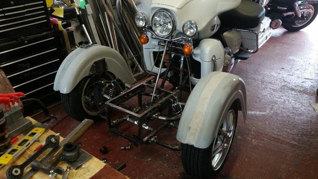

i have added a new front end now finished and so was a little perturbed by excess heat....
