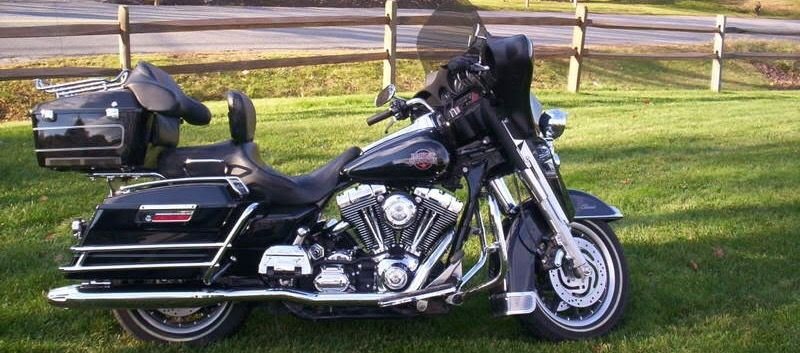

Wondering what you guys recommend for head pipes.
I am going to be finally doing a 98" kit with cams etc this winter. I want to keep with true duals and get the most out of the 98" kit.
I do have a trak link attached to my oil pan, not sure if the pipe that goes under the rear will fit.
Any info with help.
Thank you

Getting the most out of it would be a 2-1 pipe. However, when I had my 04 EGC with a 95” and 26g cams, I ran V&H duals and was happy
