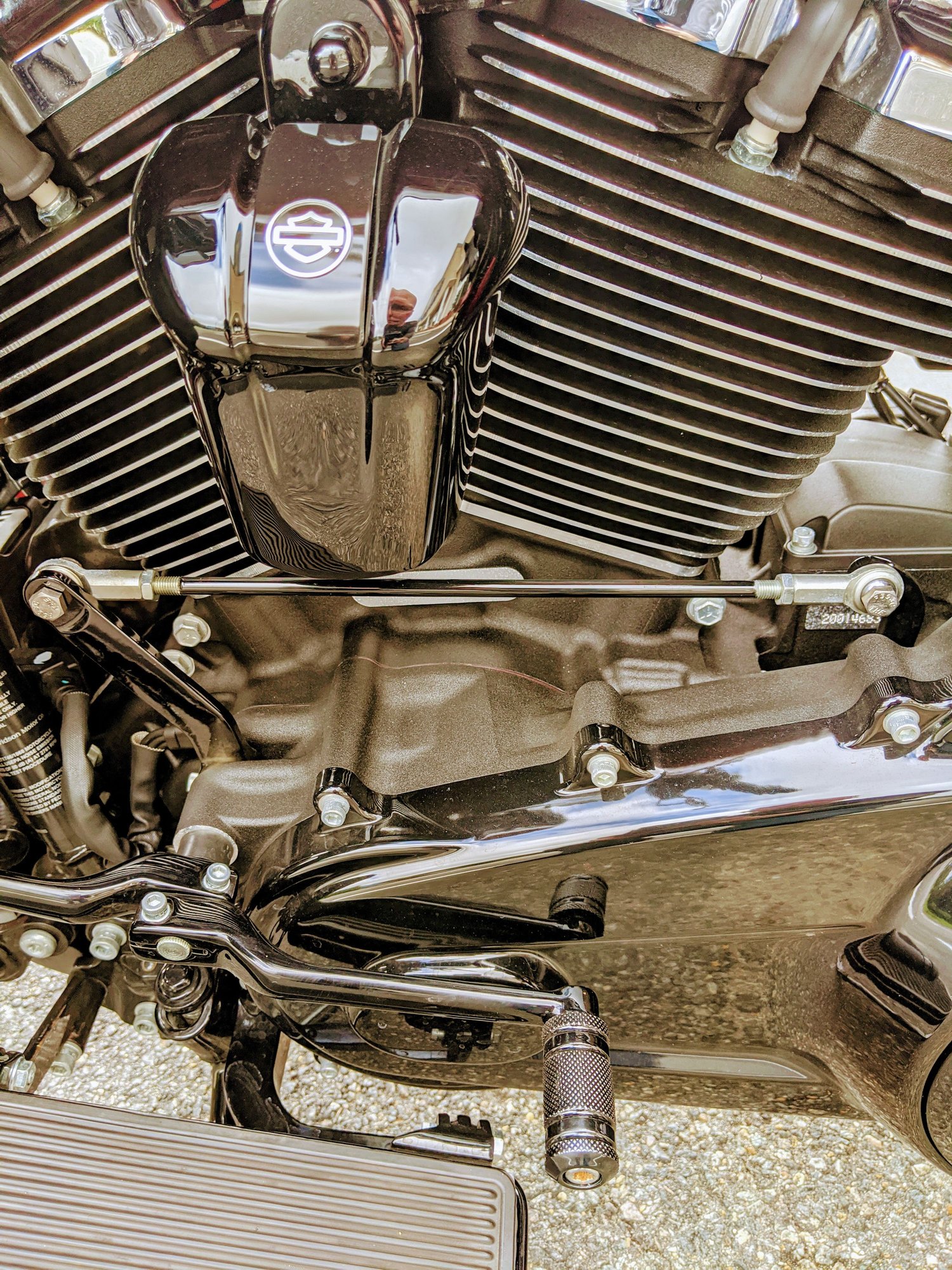

I powder coated the stock one that came with the bike and purchased a pair of stainless heim joints off eBay for around $12 bucks.

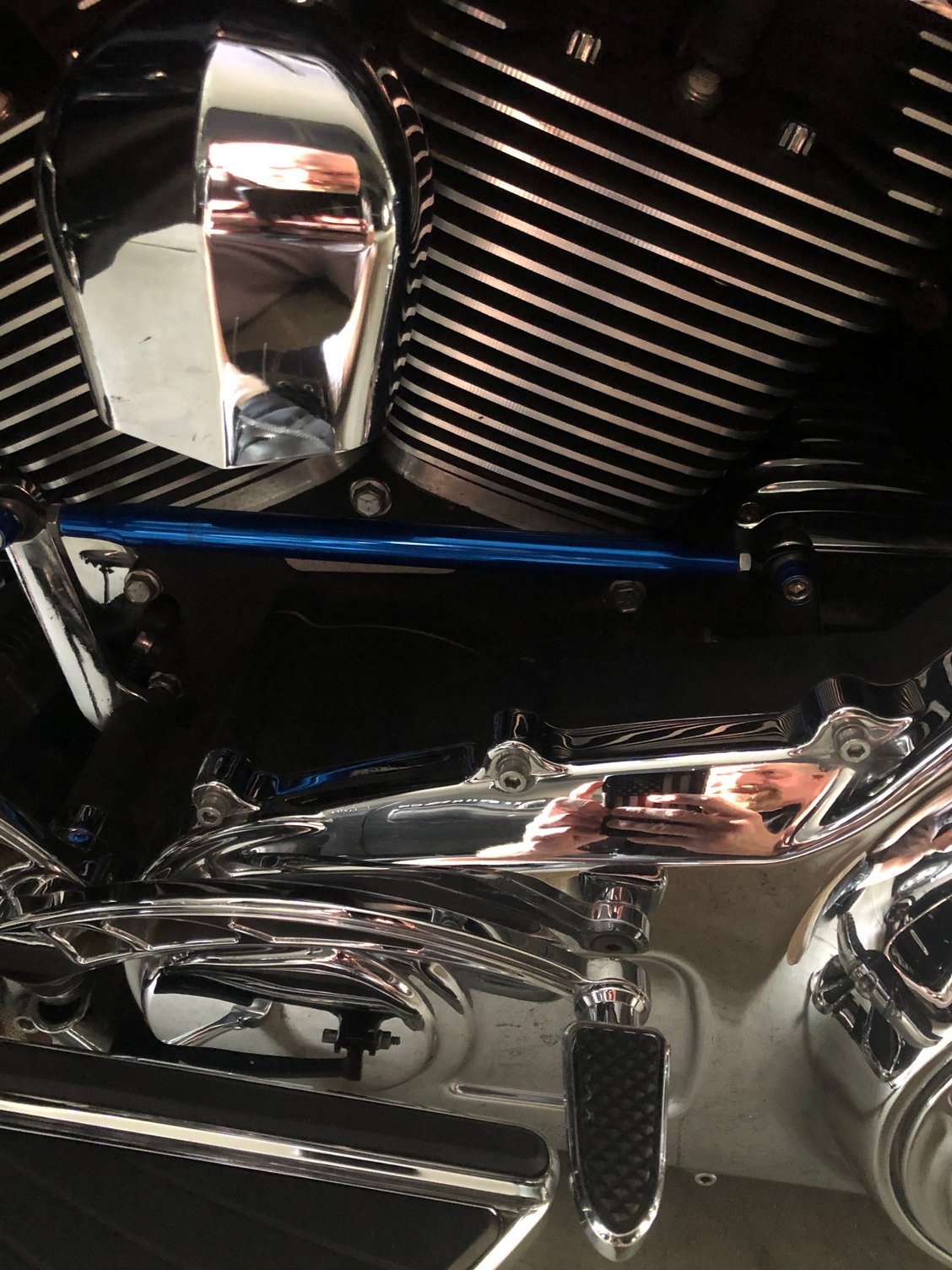

Santoro Fabworx. USA made, well built. Have one on my 13 Road Glide.

A few minutes and a few dollars with a couple of heim joints will do the trick
yup that’s what I did. Got some chrome moly hem joints from BungKing.com and used my stock linkage. The stock gems suck compared to the beefy aftermarket ones.
