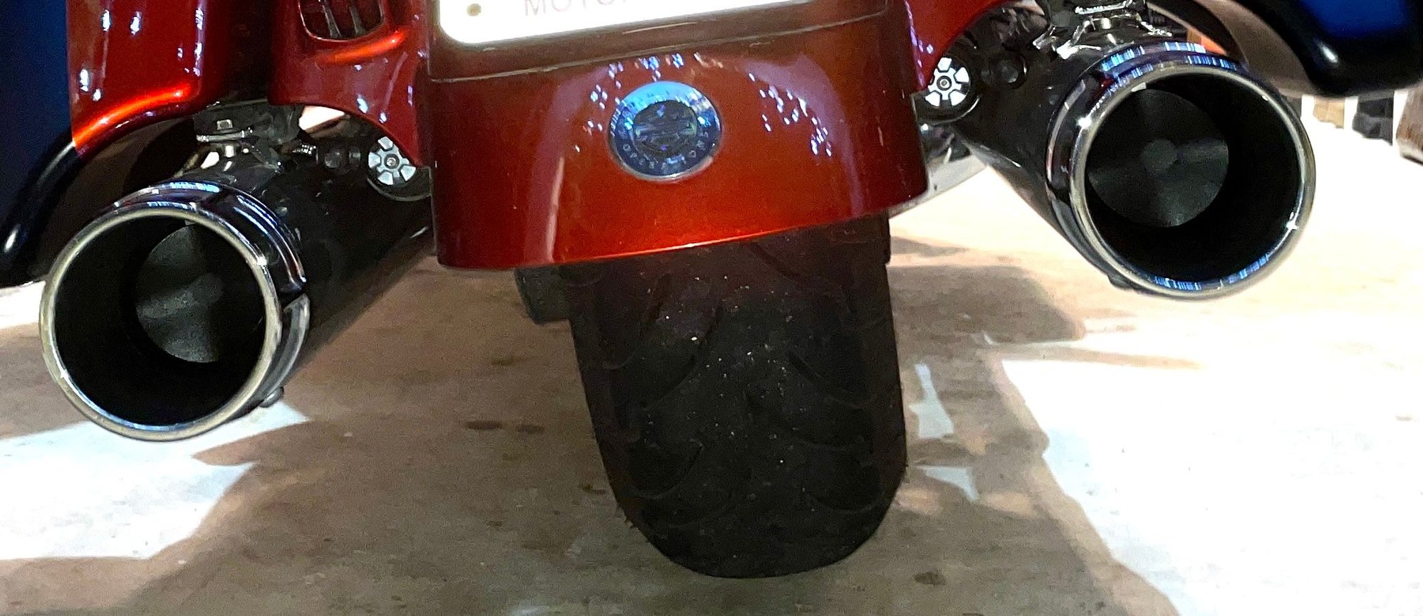

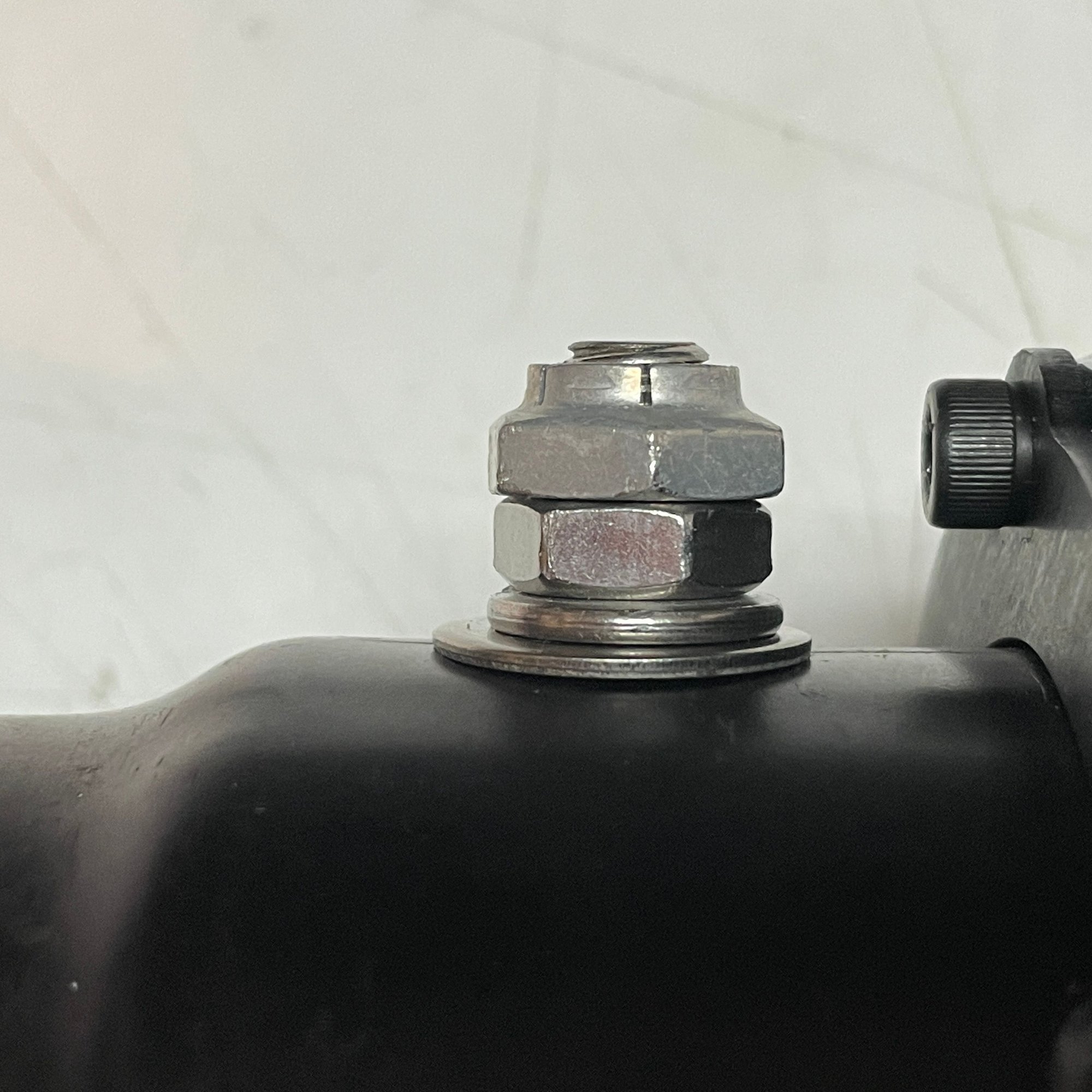

I looked long and hard at a number of options and settled on the Thunder Torque Inserts. I bought all three sizes and decided to go with the 258s, bolting them in about ž" back from where the end-cap meets the baffle. Pics below:
Mounted about ž" back from where the baffle meets the end-cap. Stacked the bolt with a locking-nut (McMaster Carr!).
Torquer 450 baffle-core is about 2˝" but expands to 3" where it meets the end-cap – the TTI 258 fits nicely in this space.
View into the pipes.
Based on a quick 50+ miles this afternoon this seems to be the icing on the cake! The bike still sounds great but has quieted down a bit. More importantly, the bike once again has great usable power from 2,000 RPMs. I'll run it this way for a bit and begin playing with the PowerVision auto-tuning to see what more can be gained. I'll hit the dyno in the Spring and share additional details then.

Ought to do the trick for ya. What size is the pipe where the TTs are located? I see it flares up right there.
