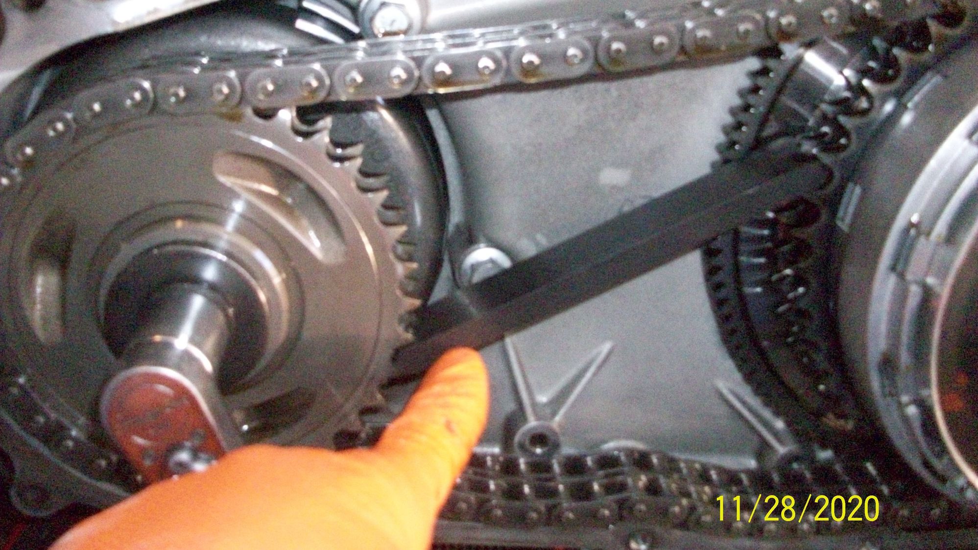

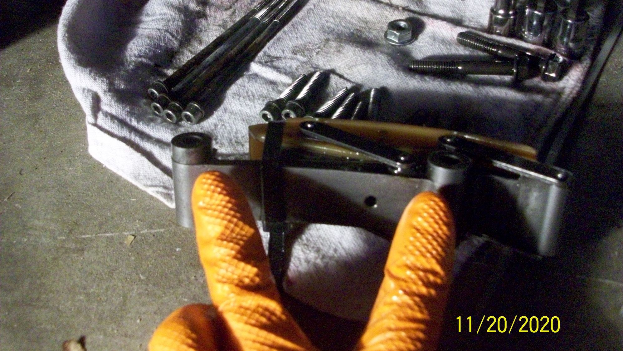

Thank you for all of the comments and suggestions. After speaking with Steve Mihali of Mihali Cycles in Riverside CA, from his experience he suggested either the Harley or Cycle Electric stator. I went with the Harley stator. Haven't finished but here are a few pictures from the job so far. It appears one of the winding spokes burned out. I purchased the Hartland Products primary drive locking bar 5.950" long which really helped in removing and replacing the bolt holding the drive sprocket. The Harley service manual is a big help. The last time the stator was replaced was in August 2010 with about 60K on the odometer with a Harley stator. There is almost 165K on the odometer now.
Thanks again
I used a large zip tie to hold the compression on the automatic chain tensioner.
There are two spacers on the back of the tensioner.
Hartland Products primary drive locking bar 5.950" long. In position for loosening drive sprocket bolt. Reverse position to tighten bolt.

Don't know what you paid for that locking bar, but gotta be less that one from Jims. Good quality stuff, but way too expensive, mostly, IMHO. I went to the local blacksmith shop, ( yeah, I live where those things still exist), and bought a length of 1/8 inch angle, cut it to length, and rounded the ends a little. Works great. I'm into it for under 2 bucks, and a little time.

you’re lucky... on the newer engines the whole primary needs to come off for that.

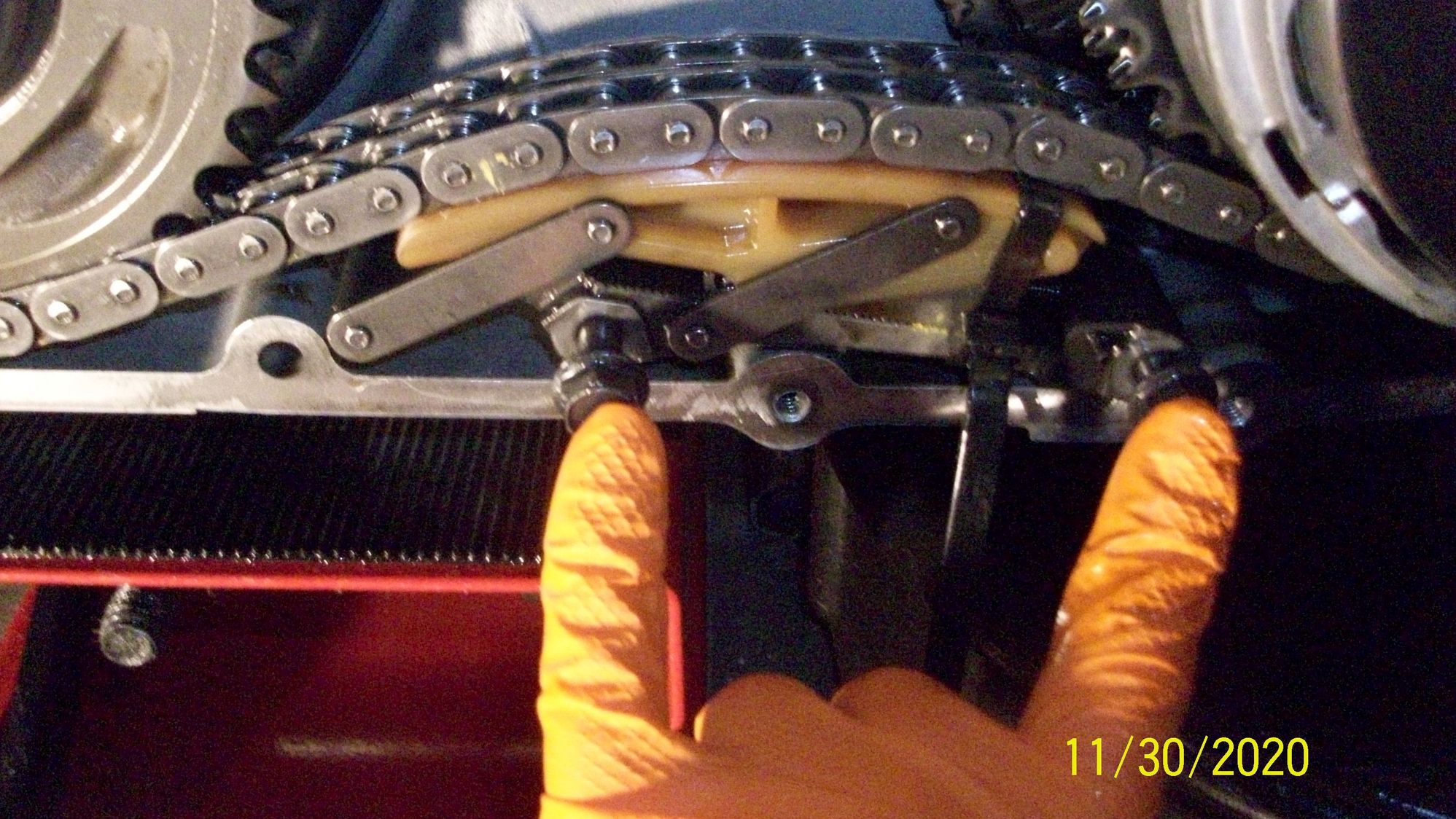

Replacing the automatic tensioner bolts. I used blue Loctite on the threads. Don't forget the spacers between the tensioner and the primary case!
I followed the torque specs in the service manual.
Don't forget to remove the zip tie!

Nicely done, I also used a piece of bar stock to wedge between the comp & clutch basket, its not that hard job with the right tools.
