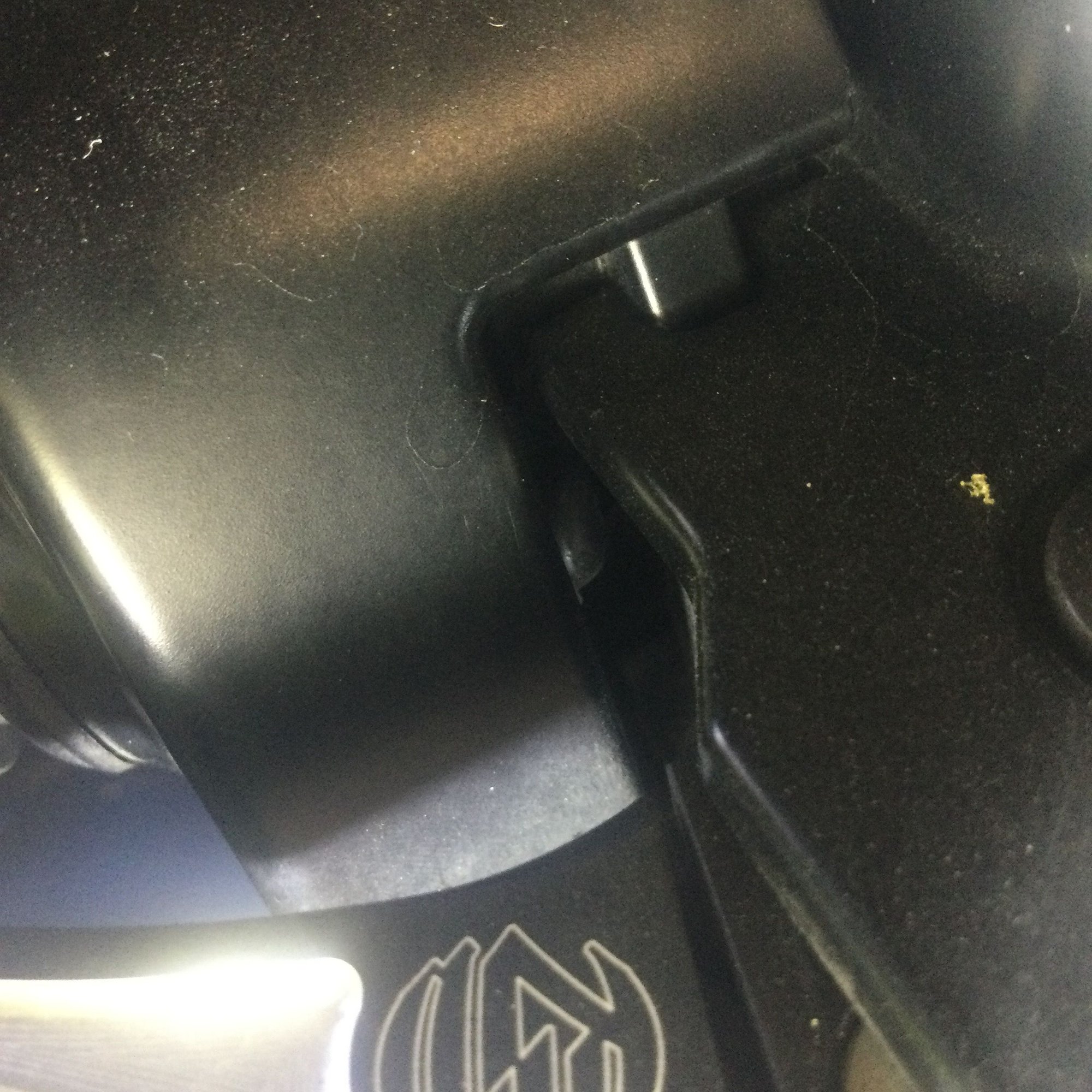

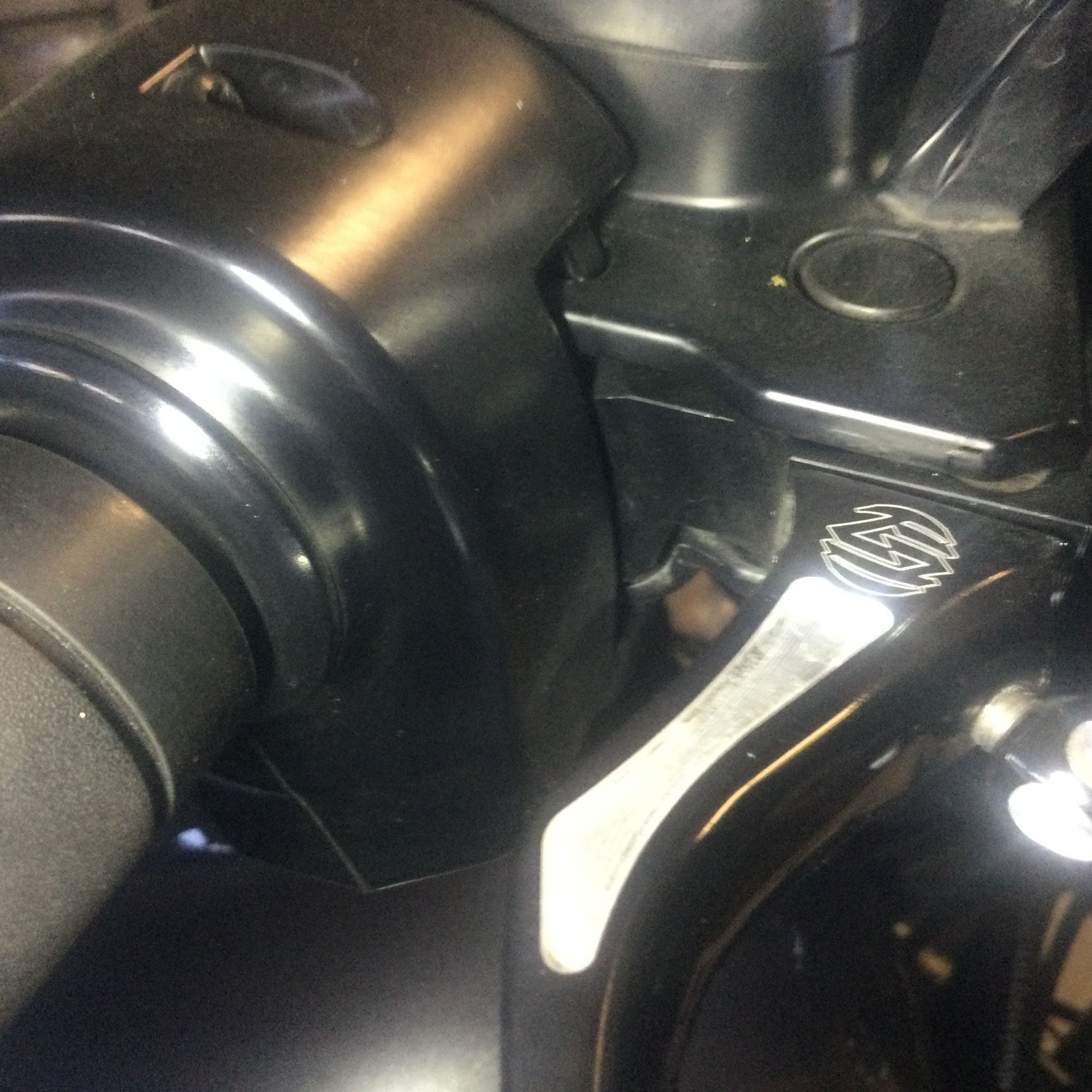

If your SG is like our Limiteds, It is a mechanical switch in the right hand control module. The control module communicates with the BCM on the CAN Buss and the BCM turns on the brake light.
Do you have any DTC's? I remember reading some have had them stick so you might try spraying some WD40 at the button if it's not moving.
Switch Button in middle of picture, lever pulled in
